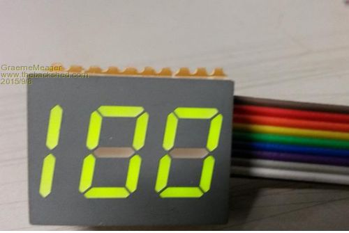

Found one.......
After an extensive search of the workshop I located the said items
And guess what? The electric jug does boil at 100 degrees Celsius according to the DS18B20.
GM

Fantastic... I like it..
One question if I may... How do you drive the 3rd digit to get the 1 in 100? You dont seem to support that in your code (at least that my feeble eyes can see)

Posted: 04:41pm 08 Sep 2015
HERE IS THE LOOP MODIFIED FOR THE THIRD DIGIT. THE ONLY PREREQUISITE IS SETPIN(23),DOUT TO DRIVE THE 100'S DIGIT.
