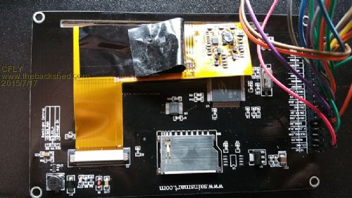

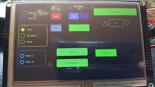

I have a screen 5 " from Sainsmart, I test it with the version MMBasic V4.7 B21.
Concerning display, no problems.
Concerning Touch panel ... not ok.

What chip is on that display, for the touch controller?
Needs to be resistive touch controller - capacitive controllers don't work, so I understand.....

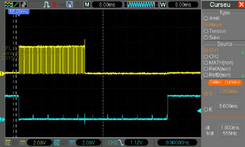

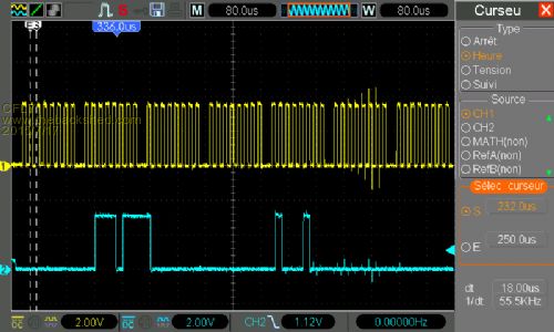

When I affect the screen the signals seem OK in the oscillo :
T_IRQ 1->0 and after 57ms T_CLK (50K) and data on T_DIN and T_DO ...

Blue : T_IRQ
Yellow : T_CLK
Blue : T_DO
Yellow : T_CLK

Do you definitely have either a TSC2046 or XPT2046 chip on the display boards?

On ili9341 : xpt2046
On ssd1963 : ? No ref like tsc or xpt ...

  Quote  On ili9341 : xpt2046
OK then this should definitely work.
Check again the connections T_DIN to SPI-OUT and T-DOUT to SPI-IN.
Can your scope do protocol analysis?
After T_IRQ you should see command &HD0 or &H90 transmitted on SPI-OUT and then two bytes received on SPI-IN. Then the other command will be transmitted and another two bytes received

Thanks Geoffg, Grogster and Matherp, concerning the lcd ili9341, it was a problem of calibration. I did not stay for a long time on every test point...
But I have redo several times the calibration to have a good result.

For 5" (ssd1963), after calibration, the screen became gradually white, then nothing more ...
I think that the screen is definitively destroyed!!
