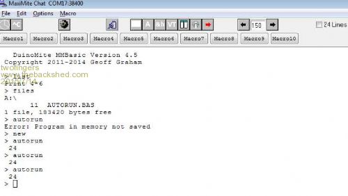

On a DuinoMite (4.5) all seems to work as expected ... nearly.
After a "NEW" I can execute "AUTORUN" on Drive "a:" repeatedly.
causality ≠ correlation ≠ coincidence
