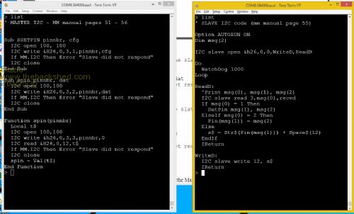

About to embark on a major project using bigmick's I/O boards so decided to set up the I2C example from the MicroMite manual (4.5).
Typed in the example code to two MM's running 4.6

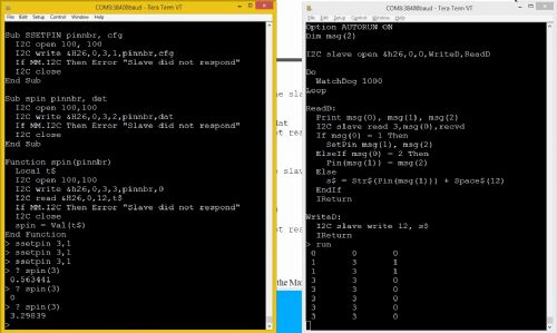

I hope the images are clear enough thought this was best way to show both Master (left) and slave (right).
This code is functionally identical to the manual (well except for the commented out print statement in the slave code).

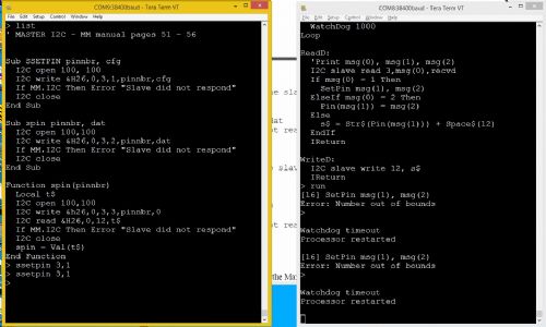

If I then run the slave and type the ssetpin command into the master I get number out of bounds error from the slave and a reboot of the slave. :-
Now if I uncomment the print statement which I inadvertently put before the I2C Slave read things work as expected. It seems to me the slave read does not handle the array correctly.

You have a sub and a function with the same name for a start - spin.
I am not sure if that is legal or not, but probably not....
Posts: 6626
Posted: 05:00pm 30 May 2015
Try putting a delay at the start of the ReadD sub.
The sub is called as soon as there is some data available but it takes time for the rest of the data to arrive.
Posting your programs as code rather than an image will make it easier for other to read it.
Posts: 10072
Posted: 05:37pm 30 May 2015
I agree with Jim - it's hard to read those images.
I would also be inclined to move most of your slave read code, into your main DO/LOOP, keeping the ReadD I2C read interrupt as short as possible - best not to hang about inside interrupts.
Could it be possible that the I2C is timing out? You could try increasing the master timeout to 250 or something - I2C OPEN 100,250 - that sort of thing. The time taken to print the three tabulated results as the first line of code in the ReadD interrupt, could possibly be taking more then 100mS, and this would cause the master to timeout waiting for the slave to respond.

@ Bizzie
I can confirm that your code, as taken straight out of the manual, fails as you indicate on line 14.
It appears that the variable cfg in the slave which is supposed to be setting the pin as a digital out (8) is actually being received as a 0 (I put a print statement prior to line 14 to give the pin and config info)
This could be a timing issue in that the cfg parameter doesn't arrive quick enough - haven't been able to check that yet.

Thanks all for you comments.
I can confirm that a pause 10 will overcome the issue.
