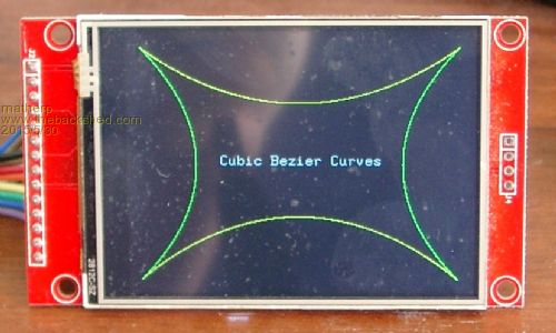

One of the new features in 4.7b8 is the ability to work with floating point numbers inside Cfunctions. The attached example wouldn't have been possible previously
option default none
option explicit
dim integer i
timer=0
i=bezier(10,10,106,80,212,80,309,10,rgb(yellow))
i=bezier(10,230,106,150,212,150,309,230,rgb(yellow))
i=bezier(10,10,80,80,80,160,10,230,rgb(green))
i=bezier(309,10,239,80,239,160,309,230,rgb(green))
text 85,110,"Cubic Bezier Curves"
print timer
end

CFunction bezier

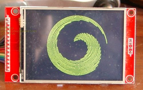

One thing you can do with Bezier curves is use them to plot arcs. To do this a bit of maths is required to calculate the control points.
But you can then plot any arbitrary arcs
option default none
option explicit
dim integer i
timer=0
for i=0 to 99 step 4
LargeArc(mm.hres/2,mm.vres/2,20+i,325+2*i,5+5*i,rgb(yellow))
next i
print timer
end
' subroutine to calculate points to use cubic Bezier splines to plot arcs greater than 90 degrees
' Parameters are:
' X coordinate of centre of arc
' Y coordinate of centre of arc
' radius of arc
' start radial of arc in degrees
' end radial of arc in degrees
sub LargeArc(x as integer, y as integer, r as integer, a1i as integer, a2i as integer, col as integer)
local integer amid, astart=a1i
if a2i<a1i then a2i=a2i+360
do while a2i-astart>90
SmallArc(x , y , r , astart, astart+90 , col)
astart=astart+90
loop
SmallArc(x , y , r , astart, a2i , col)
end sub
' subroutine to calculate points to use cubic Bezier splines to plot arcs less than 90 degrees
' Parameters are:
' radius of arc
sub SmallArc(x as integer, y as integer, ri as integer, a1i as integer, a2i as integer, col as integer)
' Compute all four points for an arc that subtends the same total angle
' but is centered on the X-axis
local float r,a1,a2,a,x1,y1,x2,y2,x3,y3,x4,y4,k,f,ar,cos_ar,sin_ar
local integer j,x1i,x2i,x3i,x4i,y1i,y2i,y3i,y4i
r=ri
a1=rad(a1i)- pi/2
a2=rad(a2i) -pi/2
a = (a2-a1) / 2.0
x4 = r * cos(a)
y4 = r * sin(a)
x1= x4
y1= -y4
k = 0.5522847498
f = k * tan(a)
x2 = x1 + f * y4
y2 = y1 + f * x4
x3 = x2
y3= -y2
' Find the arc points actual locations by computing x1,y1 and x4,y4
' and rotating the control points by a + a1
ar = a + a1
cos_ar = cos(ar)
sin_ar = sin(ar)
x1i = r * cos(a1) + x
y1i = r * sin(a1) + y
x2i = x2 * cos_ar - y2 * sin_ar + x
y2i = x2 * sin_ar + y2 * cos_ar + y
x3i = x3 * cos_ar - y3 * sin_ar + x
y3i = x3 * sin_ar + y3 * cos_ar + y
x4i = r * cos(a2) + x
y4i = r * sin(a2) + y
j=bezier(x1i,y1i,x2i,y2i,x3i,y3i,x4i,y4i,col)
end sub

Posts: 12046
Posted: 02:31am 31 May 2015
Hi paceman
I've spent a bit of time optimising - try this
now averaging 40msec / arc which seems OK
option default none
option explicit
cpu 48
const k = 0.5522847498
const pidiv2=pi/2
dim integer i
timer=0
next i
print timer
end

paceman
Joined: 07/10/2011
Posts: 1329
Posted: 04:40am 31 May 2015
That's 2250 on mine to run the whole thing above - 25 arcs plus all the other calcs, about a third of the previous code run time. It's difficult now to see each arc being plotted, they just individually appear whereas before you could follow them being plotted.
Quite impressive Peter, I'm glad you seem to know what you're doing.
