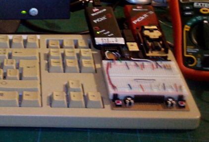

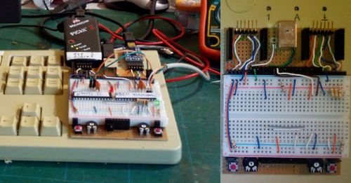

Here are two shots of an early prototype:
The first in use testing the ASCII Controller / MicroMite II combination and the second a top down view. (excuse the bad photo's, it is winter here in Cape Town and I have bad light).

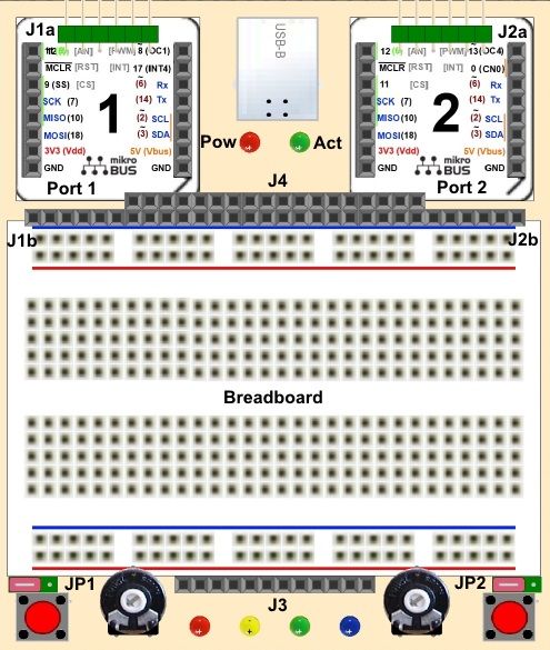

The secret to flexibility, and the longest part of the development cycle so far, is the choice of connectors and their function. The picture below is the key to what follows:
J1a/J1b and J2a/J2b are straight through, one to one, connections and act as generic ports to dock ICSP, USB Serial Converters, Test Instruments etc. The Picture of the prototype has a PICKit 2, acting as a Power Supply and Logic Tool connected to J1a and a USB to Serial Board connected to J2a. The Auxiliary USB port, situated between them, is connected from the ASCII terminal controller Chip to the PC. The white cable is the Keyboards Power and Data lines which will be routed internally in the final design.
J3 provides the Minimum I/O accessory's needed in every project, two push buttons, two POT's and four LED's. JP1 and JP2 are used to set PB1 and PB2 as active Low or active high. J3 also routes Gnd, 3V3 and 5V power connections to the bottom of the breadboard to eliminate the need for long bridge links (as seen in the photo's) and facilitate split power buses.
J4 is the heart of the system and is connected internally to the MicroMite II (Or other CPU Board) bringing all of the Pins out to the Breadboard edge. The Pins are grouped by function, as opposed to package, and sockets are also provided for Power, Auxiliary USB, The ASCII Terminal / Console Connections etc.
The Final Connectors comprise two expansion Ports that conform to the mikroBUS Standard. I chose mikroBUS as a standard prototyping bus several years ago and am pleased to see other Development Board manufacturers have started to do the same. The standard requires an article on its own but suffice it to say that this BUS can now be found on Arduino Clones, Beagle Bone Boards and several other 3rd Party CPU boards along with Large development boards such as the EASYPic range.
Hundreds of modules, ranging from WiFi to GSM and GPS, as well as simple LED Bar-graph and Rotary encoder boards are now available to plug in to it. And the form factor makes it easy to design your own modules on VIRO Board. The Photo above shows a PICKit 2 and a PICKit 3 connected to the ISCP ports and a home made RTC Module plugged into the microBUS 2 Port.

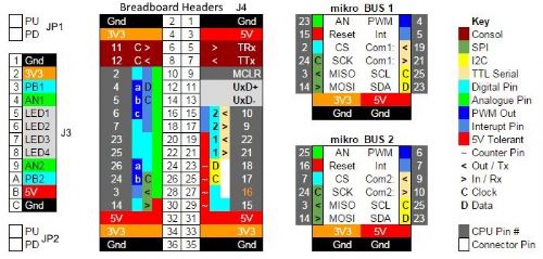

Finally here is the PIN Map showing how everything is connected:
In a future post I will describe the mikroBUS in greater detail and then the actual CPU's installed inside the Keyboard, but for now I hope this gives others an insight into how to design/build your own flexible Development Breadboard.
