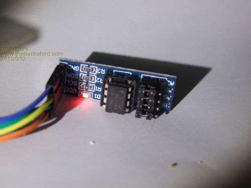

Posted: 01:01am 12 May 2015
@Jim
my2c:
If it has to be an affordable solution then I would recommend a 24C256 EEProm (32KBytes, costs ~1$ from china).
Endurance: Good enough for more than 20 years!
Be not afraid of page boundaries!
