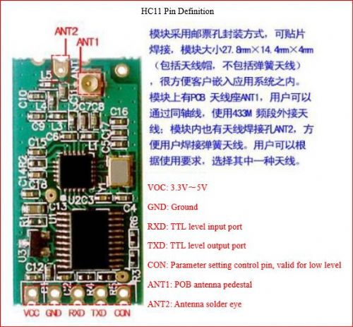

HOWEVER, I think I'm now about to box above my weight because I want to read data wirelessly, sent from outside the house say. I already have a pair of transceivers,
HC-11 433MHz wireless RF serial UART, unused because I defected to micromite,

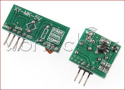

433Mhz RF transmitter and receiver kit Module

Also worth noting is that smart modules don't need these U's - the first modules in your photos look like this type, but I don't have any of those.
