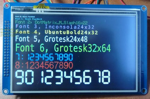

The other main change in this release is the implementation of in-built graphics routines. The following controllers are currently supported:

Once the display is open there are a range of drawing commands available:
DISPLAY font, xstart, ystart, foreground colour, background colour, textstring, (optional x-scale, or x and y if only this parameter specified),(Optional y-scale)
10 fonts are currently included as shown in the picture. The code includes wordwrap and protection against writing outside the screen area. All fonts can be scaled using the x-scale and y-scale parameters but note this does introduce a performance overhead.

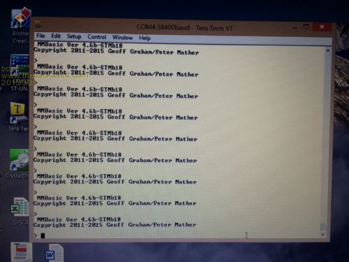

Maybe I found the glitch - embedded EDITOR doesn't work for me although via MMedit I everything seems be O.K.

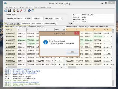

Boot x VDD connected, the chip was completely erased, then flashed and verified. The result is the same. Everything looks fine, even flash x file verification (see picture). No other problem was found yet, but embedded Editor.

Terraterm 4.86 and W 8.1 pro. It behaves madly. Greeting message prints 9 times, the reset button seems not working now. I'll install one more disk and try it again with fresh installed W7. What kind od Windows you have installed? Could virus infect hex file? I don't know. b12 seems working fine.
Bo
Posts: 12045
Posted: 05:57am 21 Mar 2015
  Quote  Greeting message prints 9 times, the reset button seems not working now
That sounds like the reset pull-up resistor is missing/dry joint
I'm using W7 64-bit, Teraterm 4.82, FTDI (possibly) adapter
Also, make sure you are only using three wires from the USB/TTL adapter, GND, RX, TX - you don't want to connect VCC
Attached is a version of b19 that should default to USB rather than UART for the console
2015-03-21_160543_ARMmiteb19USB.zip Edited by matherp 2015-03-22

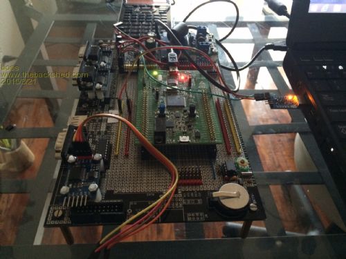

All mine FTDI went to the garbage can as I decided upgrade to 8.1 and FTDI doesn't support it under W8. I switched to CP210x and they working fine.
there are some picture, the Discovery board is firmly inserted in big prototype board, there could be absolutely no Discovery board damage
Hope that iPhone didn't flip picture upside down as happened last time
Will continue with W7
Bo
Posts: 12045
Posted: 08:04am 21 Mar 2015
I can only suspect something about your proto board is shorting out the NRST and GND pins - this is definitely not a software issue
boss
