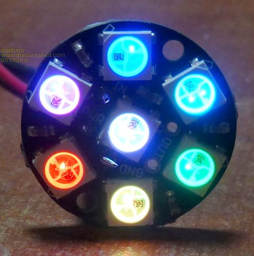

I received one of these in the post today:
So I was able to properly test the code for sending out the pulse sequences and convert it into G8JCF-approved library format (I hope )
I was going to upload a video to YouTube but my camera found it completely impossible to video the display so a static picture must suffice.
The attached code contains a simple example that fades in and out the colours and rotates them around the ring - I wish I had some artistic flair but that will have to do as an example!
The code should be able to handle any number of WS2812 LEDs in the string - power supply and cost will be the limiting factors.
The Cfunction code is included as comments. Remember to get rid of BB created spaces before running - I think they are only in the P40$ and P28$ strings.
The WS2812.init routine sets the CPU speed to 48, the Cfunction will only operate correctly at this speed.
Enjoy

Posts: 2994
Posted: 10:24am 10 Feb 2015
You NEVER cease to amaze . . . . . .
(and you're costing me a fortune in opto gadgets)
Zonker
Joined: 18/08/2012
Posts: 772
Posted: 11:31am 10 Feb 2015
Sweet Pete..!!
Just got off work.... Will give a 1 LED setup a tryout... Looks nice
Thank you Dr. Awesome..
EDIT: Yikes... I can't seem to find the part... It's here somewhere..!Edited by Zonker 2015-02-11
aargee
Joined: 21/08/2008
Posts: 255
Posted: 12:36pm 11 Feb 2015
Matherp... thanks for the code and the work you've done with Neopixels and the WS2812.
For all those wanting to run the demo program above, be aware that Matherp has written it for his string of seven LEDS.
I changed it to successfully run my five LEDs although if I change it to run a 30 LED string, the 'colours' array bombs out.
Just ran out of time, I'm off to work for now...

EXAMPLE 'execute the example program
End
'___________________________________________________________ ____________________________________________________________ _______________
'number of LEDs, PIC port numer (0=A..2=C), Pin number within the port, array of colour codes, buffer array used by the CFunction
CFunction WS2812.Pulses
00000000
8fa30010 24020001 8ccc0000 01826004 8ca60000 14c20003 8ca50004 10a00009
3c0ebf88 24020002 14c20003 3c0ebf88 50a00007 25cd6234 25cd6034 10000005
25ce6038 25cd6134 10000002 25ce6138 25ce6238 34058000 3c02bf80 ac450600
8c820004 1c400005 8c880000 14400025 00000000 11000023 00000000 0060c021
00007821 1000001c 240bffff 30490020 8ce80004 00085040 00022827 00aa5004
8ce50000 00452806 01452825 00484007 0109280b 30a50001 a0c50000 2442ffff
144bfff2 24c60001 25ef0001 8c880000 8c820004 27180018 000f2fc3 00a2302a
14c00005 24e70008 14450006 01e8482b 11200004 00000000 03003021 1000ffe3
24020017 5c400006 3c02bf80 1440000b 3c05bf80 2d08001d 15000008 3c02bf80
8c460c00 3c05ffff 24a57fff 00c52824 ac450c00 10000006 8c820000 8ca20c10
2c420065 1040fffd 00000000 8c820000 000228c0 00021140 00453823 10e00025
00001021 3c05bf80 00623021 90c60000 10c0000f 00000000 adcc0000 aca00610
8ca60610 2cc60019 14c0fffd 00000000 adac0000 aca00610 8ca60610 2cc6000d
14c0fffd 00000000 1000000e 24420001 adcc0000 aca00610 8ca60610 2cc60005
14c0fffd 00000000 adac0000 aca00610 8ca60610 2cc60014 14c0fffd 00000000
24420001 1447ffe1 00623021 10000003 8c830004 00e01021 8c830004 5c600008
3c03bf80 14600009 00000000 8c830000 2c63001d 14600005 00000000 3c03bf80
8c640c00 34848000 ac640c00 adac0000 03e00008 00001821
End CFunction
'long long WS2812.Pulses(long long *numleds, long long *portname,long long *mypin,long long parray[], unsigned char sarray[]){
' #define tmr4 *(volatile unsigned int *)0xbf800C10 //timer 1 configuration register
' #define tmr4con *(volatile unsigned int *)0xbf800C00 //timer 1 configuration register
' #define tmr1con *(volatile unsigned int *)0xbf800600 //timer 1 configuration register
' #define tmr1 *(volatile unsigned int *)0xbf800610 //timer 1 counter
' unsigned int index,pin=1<<*mypin;
' int k,bpos;
' unsigned int volatile * mysetport;
' unsigned int volatile * myclearport;
' if(*portname==0) {
' mysetport=(volatile unsigned int *)0xbf886038;
' myclearport=(volatile unsigned int *)0xbf886034;
' if(*portname==1) {
' mysetport=(volatile unsigned int *)0xbf886138;
' myclearport=(volatile unsigned int *)0xbf886134;
' if(*portname==2) {
' mysetport=(volatile unsigned int *)0xbf886238;
' myclearport=(volatile unsigned int *)0xbf886234;
' tmr1con=0x8000; //turn on timer at full speed
' index=0;
' for(k=0;k<*numleds;k++){ //move the data into a single dimensional array that we can step though in even time
' for(bpos=23;bpos>=0;bpos--){
' sarray[index]=(parray[k]>>bpos) & 1;
' index++;
' if(*numleds > 28) { //Decide how to avoid RTC interrupts
' tmr4con &= 0xFFFF7FFF; //turn off the real time clock if it is going to interfere
' } else {
' while(tmr4>100); //synchronise with the RTC to avoid interrupts
' k=*numleds * 24;; //get the number of bytes to output
' for (index=0;index<k;index++){ //step through the input data
' // Note the timer settings are not obvious as the execution of the loop elongates the low pulses
' if (sarray[index]){
' *mysetport=pin;
' tmr1=0;
' while(tmr1<25); //Tuned for the 700ns pulse
' *myclearport=pin;
' tmr1=0;
' while(tmr1<13); //Tuned for the 600ns pulse
' } else {
' *mysetport=pin;
' tmr1=0;
' while(tmr1<5); //Tuned for the 350ns pulse
' *myclearport=pin;
' tmr1=0;
' while(tmr1<20); //Tuned for the 800ns pulse
' if(*numleds > 28) tmr4con |= 0x0008000; //turn the clock back on
' *myclearport=pin; //Set the output low to create the reset pulse which loads the data
' return index;
' Load the colour array for a specific LED from the green, red, and blue components
Sub WS2812.setcolour(led As integer, greenness As integer, redness As integer, blueness As integer)
colours(led)= ((greenness And &HFF)<<16) + ((redness And &HFF)<<8) + (blueness And &HFF)
End Sub
' Get the green, red, and blue components for a specific LED from the colour array
Sub WS2812.getcolour(led As integer, greenness As integer, redness As integer, blueness As integer)
greenness=colours(led)>>16
redness=(colours(led)>>8) And &HFF
blueness= colours(led) And &HFF
End Sub
' uses the pin number to get the port number and the pin number on the port by reference to the Device ID
Function WS2812.getpin(MMpin As integer,portnum As integer,pinnum As integer) As integer
Const P28$="N/AA00A01B00B01B02B03N/AA02A03B04A04N/AB05B06B07B08B09 N/AN/AB10B11B12B13B14B15N/AN/A"
Const P40$="B09C06C07C08C09N/AN/AB10B11B12B13A10A07B14B15N/AN/AN/A A00A01B00B01B02B03C00C01C02N/AN/AA02A03A08B04A04A09C03C04C05 N/AN/AB05B06B07B08"
Local integer i
Local a$ length 3
i=(MMpin-1)*3 +1
If (Peek(word &HBF80F220) And &HFFFFFFF) = &H6610053 Then
If MMpin>=1 And MMpin<=28 Then
a$=Mid$(p28$,i,3)
Else
a$="N/A"
EndIf
Else
If MMpin>=1 And MMpin<=40 Then
a$=Mid$(p40$,i,3)
Else
a$="N/A"
EndIf
EndIf
If a$="N/A" Then
WS2812.getpin=0
Else
portnum=Asc(Left$(a$,1))-65
pinnum=Val(Right$(a$,2))
WS2812.getpin=1
EndIf
End Function
' Initialise required global variables depending on the number of LEDs and set up the output pin and CPU speed
Sub WS2812.INIT(LED_PIN As integer,nLEDs As INTEGER)
CPU 48 'This speed is fixed for the Cfunction to work
' Global variables
Dim INTEGER NUMLEDS=nLEDS
Dim integer buffer(NUMLEDS*3-1)
Dim INTEGER colours(NUMLEDS)
Dim integer portnum,pinnum
SetPin LED_PIN,dout
Local INTEGER i=WS2812.getpin(LED_PIN,portnum,pinnum)
End Sub
Sub EXAMPLE
Local integer i,j,green,red,blue,maxbright=40
WS2812.setcolour(0,maxbright,maxbright,maxbright) 'white
WS2812.setcolour(1, maxbright,0,0) 'green
WS2812.setcolour(2,maxbright,maxbright,0) 'yellow
WS2812.setcolour(3,0,maxbright,0) 'red
WS2812.setcolour(4,0,maxbright,maxbright) 'magenta
'WS2812.setcolour(5,0,0,maxbright) 'blue
'WS2812.setcolour(6,maxbright,0,maxbright) 'cyan
For j=1 To maxbright-1
i=WS2812.pulses(NUMLEDS,portnum,pinnum,colours(),buffer())
For i=0 To Rob
WS2812.getcolour(i,green,red,blue)
If green<>0 Then green=green-1
If red<>0 Then red=red-1
If blue<>0 Then blue=blue-1
WS2812.setcolour(i,green,red,blue)
Next i
Pause 10
Next j
rotate
For i=0 To Rob
If green<>0 Then green=green+1
If red<>0 Then red=red+1
If blue<>0 Then blue=blue+1
Next i
Pause 10
Next j
Loop
End Sub
Sub rotate 'rotates the colours round the edge of the display leaving white in the middle
Local integer i,j
i=colours(Rob)
For j=Rob-1 To 1 Step -1
colours(j+1)=colours(j)
Next j
colours(1)=i
End Sub

Posts: 12059
Posted: 12:12am 13 Feb 2015
aargee
Did you get the code working for the 30 LED string?
I've checked it on the oscilloscope and it certainly seems to send the correct signals.
These is one very strange thing about these devices. With a normal shift register such as the 74HC595, the last bit sent ends up in the first device in the chain so if I have three chained together and I send 3 bytes of information the first byte sent loads into the third device.
The WS2812 is completely the opposite. The first device in the chain "captures" the first three bytes (24-bit colour word). No matter how many more bytes I send this first WS2812 will load the first colour word sent when the load pulse occurs. This continues down the chain.
This does mean that you can send any number of colour words to a chain and depending on the length of the chain, say N leds, it will always be colour words 1 to N that are used, the remainder just clock out of the last WS2812 in the chain.Edited by matherp 2015-02-14
plasma
Joined: 08/04/2012
Posts: 437
Posted: 02:38am 13 Feb 2015
@matherp
My code is testet with 245 leds and need no second array.
Maybe if you mixed the codes ....
Gtx
Zonker
Joined: 18/08/2012
Posts: 772
Posted: 11:58am 13 Feb 2015
@Matherp...
So, (talking about the LED's), From what you are saying... The first LED takes in 3 bytes, (24bits) and knows it's his data to store. That means nothing comes out of his output pin until he gets his 24... Then, he just passes the rest of the bits to his neighbor down the way... Humm... Then we should be able to see nothing coming out of the output pin until 24 bits have elapsed on each IC... There can't be any "no-op" code to pass because all possible codes are used for RGB data. In the LED controller code, the firmware would take the first 24 bits, then hook-up the input pin to the output pin to pass the rest of the "other" data...
If "Mr. Scope" shows data being shifted out early, then I am totally confused on how it's being done... Each LED doesn't know where it sits in the string... (if any)...
P.S. - I still haven't found the only one I got from Spark-fun...
However, it's payday..! (will be getting more)
aargee
Joined: 21/08/2008
Posts: 255
Posted: 02:40am 14 Feb 2015
I haven't actually tried it with the 30 string, but its behaviour seems to indicate that it should work.
The C Function bit is OK, it was just the "Example " part of the program that you had tuned to your 7 LED board that needed modification.
I'll see if I can check it before the weekend is over.
