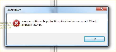

This is the error I get when MMEdit crashes
Error log attached
2015-01-09_193416_ERROR.zip Edited by matherp 2015-01-10
Posts: 6626
Posted: 10:31am 09 Jan 2015
@matherp
Thanks for the error log.
It is not much help as it stands but it does rule out a lot of possibilities which is a start.
That error is usually caused by writing to an area of memory that Windows is not happy about.
What were you doing when it happens and can I have a copy of your "configuration report"
Posts: 12045
Posted: 10:51am 09 Jan 2015
I think it normally happens when I press the little man with the torch to load the program.
What do you mean by the configuration report?
rgds
Peter
Posts: 6626
Posted: 11:42am 09 Jan 2015
From the Help menu/Configuration report
You will have to copy and paste it into a text file.
That way I can see what options you have selected so I can use the same settings.
I assume you are doing this with large programs full of cfunctions.
When you do a 'load and run', a progress window opens up.
A copy of the contents of that window will tell me how far through the various stages we are getting before the error. That window should stay open for 20 seconds but I am not sure what will happen when the error occurs.
MMEdit is written in Liberty Basic.
Liberty Basic is written in SmallTalk.
The error message is one generated by SmallTalk so it gets tricky to track it down.
Once I can replicate the error here, I will have an easier task.
