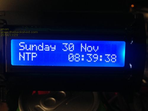

Hi
After much trial and error with NTP I finally have a working clock.
Two challenges had to be over come.
1st how to send a valid request via UDP
2nd decipher the response from the NTP Server
The request is done via UDP and consists of a 48 Bytes
the 1st byte is the important one as this contains the LI, Version and Mode
so we set the byte with the following
LI 00 = no warning (2 bits)
VN 010 = version 2 (3bit)
Mode 111 = reserved for private use (I assume I am private :) )
so the first byte = &B1011 or 23 decimal or Chr$(27) that's what we have to use to send the correct value via the com port (Would be a great feature to be able to send hex values from via the com port)
The returned data consists of 48 bytes with the data we are after in bytes 40-43
the value of the returned data is a 32 bit number made up of the 4 bytes with byte 40 MSB and byte 43 LSB. This number is the number of seconds since 00:00:00 1/1/1900 to get to Epoch time (1/1/1970) we need to - 2208988800 (Seventy years in seconds)
From there we can work out the time.
If anybody has better or cleaner way to convert the Epoch time to human readable
time please do share.
To connect to the internet this system uses an ESP8266 WiFi module connected to com1 these are really cheap and make a great way to connect a Mite to the internet
note we are NOT concerned or using the advanced NTP features such as request latency etc..
