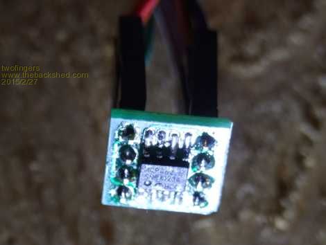

This is my small MCP4822(SOIC), there also PDIPs available:
The MCP4822 is not only a dual 12Bit DAC, it's also a highly precise voltage reference. Really much better than I expected! Cheap and very easy to handle with our microcontrollers.
