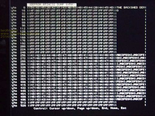

Hi all,
this is my new I2C EEPROM Maximite Library v.82 for AT24C32. Many of us know this 32kb chip from cheap DS1307 or DS3231 RTC modules. Most Parts (excluding eeDump? and eeMon) of this library should also work with all 'Mites - I hope so! I did some research to find out the "wear out" behavior. I came to the conclusion that a read event after a write event only after one second delay reliable results delivers (a write takes 0.005 sec or even less!). Therefore I removed the verify routines for short writes, but I kept it for eeErase ... and as demo in eeSaveF4 (not reliable!!).
In most cases I think you dont need a verify because the endurance is 1 Million Write Cycles (says ATMEL) or even more. My test EEPROM showed its first weakness after 3.5 Million Write Cycles! This does not necessarily mean that the data are retained for 100 years. With this EEPROM we can do a reliable Data Logging. There is space for more then 1000 floating point numbers (eeSaveF4).
Please note: The I2C Address must be set for your specific EEPROM!
On Maximites using eeMon you can now easily scroll through the EEPROM content.

Print "Writing at 0 'THE BACKSHED DEMO'"
eeWrite$ 0,"THE BACKSHED DEMO"
For i = 1 To 25
a$=a$+"ABCDFEGHIJ"
Next i
A$=A$+"ABCDF"
Print "Writing at 256: "A$:Print:Print
eeWrite$ 256,A$
Print:Print "reading back:"
Print eeRead$(256)
Print
Print eeGet$(0,17)
waitkey"press any key for eeMon"
eeMon

Sub eeMon 'eeMonitor
' Shows content of EEPROM
' You can navigate and scroll through
Local i, upArrow,dnArrow,pageUp,pageDn,LinesPerScreen,KeyText$
Local EndKey, HomeKey, EscKey
upArrow=128
dnArrow=129
HomeKey=134
EndKey =135
pageUp =136
pageDn =137
EscKey =27
MsgPos =62*6
LinesPerScreen=MM.VRes/12-3
KeyText$="Control: Cursor up/down, Page up/down, End, Home, Esc"
Cls
Font #1,,1
Print @(60,0)" <EEPROM AT24C32 DUMP &H"+Hex$(I2CPROM)+"> "
Font #1,,0
For i = 0 To LinesPerScreen
eedump i *16,16
Next i
i=i-1
Print @((MM.HRes-Len(KeyText$)*6)/2,MM.VRes-12) KeyText$
Print @(MsgPos,0) Space$(20) 'clear error message
Do:AscKey=KeyDown:Loop While AscKey=0
If AscKey = dnArrow And i < 255 Then
scrollup
i=i+1
Print @(0,MM.VRes-24);:eedump i *16,16
Else
If AscKey = dnArrow Then
PrintFlash MsgPos," UPPER LIMIT! "
EndIf
EndIf
If AscKey = upArrow And i > LinesPerScreen Then
scrolldn
i=i-1
Print @(0,12);:eedump i *16-33*16,16
Else
If AscKey = upArrow Then
PrintFlash MsgPos," LOWER LIMIT! "
EndIf
EndIf
If AscKey = PageUp And i > LinesPerScreen Then
offset=i-LinesPerScreen*2-1
If offset<0 Then offset = 0
For i = offset To offset+LinesPerScreen
eedump i *16,16
Next i
i=i-1
Else
If AscKey = PageUp Then
EndIf
EndIf
If AscKey = PageDn And i < 255 Then
offset=i+1
If offset+LinesPerScreen>=255 Then offset = 255-LinesPerScreen
eedump i *16,16
Next i
i=i-1
Else
If AscKey = PageDn Then
EndIf
EndIf
If AscKey = HomeKey And i > LinesPerScreen Then
offset=0
eedump i *16,16
Next i
i=i-1
EndIf
If AscKey = EndKey And i < 255-LinesPerScreen Then
offset=255-LinesPerScreen
eedump i *16,16
Next i
i=i-1
EndIf
If AscKey = EscKey Then Exit
Loop
End Sub

This code should replace the older EEPROM0.5.zip.
edit (Update)
Download:
2014-09-10_073035_EEPRO82.zip
Any corrections, suggestions and critics are welcome!
2,12,17,30 and 73!!
Michael Edited by twofingers 2014-09-11

Print "Press any key to continue ... (Esc=cancel)"
' display buffer content
For I=FromByteNr To FromByteNr+amount-1 Step 16' 4095 Step 16
Print "Byte ";str$(I,4);" ||";
For y = 0 To 15
Print Right$("0"+Hex$(RTCBUFF(I+y)),2);"|";
Next y
Print "|";
For y = 0 To 15
If RTCBUFF(I+y) >=32 And RTCBUFF(I+y)<=126 Then ' show ascii only
C$=chr$(RTCBUFF(I+y))
Else
C$=" "
EndIf
Print C$;
Next y
Print "|"
'waitkey"press any key"
Do:Key$=inkey$:Loop While Key$=""
if Key$=chr$(27) then
Do:pause 200: Loop While inkey$<>""
exit sub
endif
Next I
End Sub
