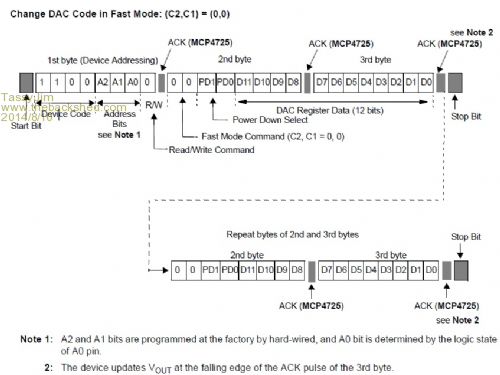

'*** I2C MCP4725 ***
MCP4725_addr = &B1100010 ' MCP4725 address with A0 = 0, A1 = 1 A2 = 0
' A0 is set by the enduser, A1 and A2 are factory set
I2C open 100, 1000 ' Enable I2C
do
for n = 0 to 4095 step 10
hibyte=n \ 256
lobyte=n mod 256
print hibyte, lobyte
I2C write MCP4725_addr, 0, 2, hibyte,lobyte
Pause 5000
next n
loop
A VERY slow ramp with the 5000mS delay.
The data sheet is typically confusing.
The 'fast mode' is the simplest to start with and PD1/PD0 can stay at zero. That should keep most of us happy.
You do need to know how the address bits were set in the factory. In my case A1 is set and A2 is zero.
Trial and error will sort it out if needed.
@Grogster,
We are sending bytes with I2C so 255 is the maximum you can send.

I re-tried using the I2C option set to 0 again, and it seems to still be working ok... Not sure why it wasn't before... Anyway, the DAC chip comes with the EEprom DAC value set to mid-scale. I want to update the stored start-up value to 0, so I need to figure out that one next... Also, if I want to read back the DAC value, then is it correct to use address &H61 instead of &H60 as the last bit controls the read/write function of the IC..?
Thanks for the feedback Gent's..!

Posts: 6626
Posted: 07:04pm 09 Aug 2014
  Zonker said   Humm...
MMBasic does all the read/write bit setting. Just keep the address at &H60
In your case, &H60 is the upper 7 bits.
Some datasheets confuse the issue by giving the full 8bit value, in which case you would need to divide by two.
If the address given in the datasheet is greater than 7F, you need to divide by two, otherwise leave it as is.
