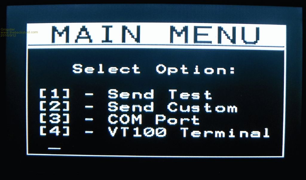

I really like the VT100 for simple B/W output from a Micromite or other.
The routines I have been using recently:
Sub MENU (T$)
WIPE
Print #2,Chr$(27)+"[6m"; 'Select Jumbo font
Print #2,Chr$(27)+"[7m"; 'Select Inverse Video
Print #2,Chr$(27)+"[4m"; 'Select Underline mode
Print #2,T$ 'Print menu title
STANDARD 'Select standard text mode(turn all text attributes off)
Print #2,NL$ 'Blank line for space
LARGE 'Select Large font
End Sub
Sub WIPE
Print #2,Chr$(27)+"c"; 'Reset terminal
Print #2,Chr$(27)+"[2J"; 'Clear entire screen
Print #2,Chr$(27)+"[H"; 'Cursor to top-left
End Sub
Sub BORDER
Print #2,Chr$(27)+"[Z2;0;0;285;212Z"; 'Draw border box
End Sub
Sub LARGE
Print #2,Chr$(27)+"[3m"; 'Large font
End Sub
Sub STANDARD
Print #2,Chr$(27)+"[0m"; 'Standard font
End Sub

Posts: 10074
Posted: 02:28pm 13 Sep 2016
Oh yeah, sorry everyone - that code I posted is for a MM controlling a VT100 chip.
I just posted it for the text size commands etc, but I expect you can extract that easy enough from that example code. Probably should have said that above - sorry for any confusion there....
