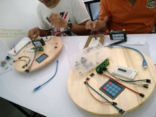

We made a starterkit for every participant with all the needed parts:

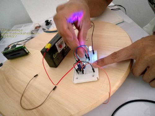

Once the power supply was breadboarded it was measured with a digital multimeter to check the voltages. We then also checked a RGB led and learned what a anode and cathode was and how to determine that.

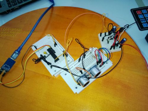

Having a good power supply it was now time to connect it to a pc by using a USB-serial adapter. We made sure the adapter was using 3.3v for its rx and tx lines and connected those wires to the MicroMite together with a ground connection. We did not use the usb power.
After some setup of computers, some needed loading drivers, and configuring Tera Term it was time to write some code.
As we already had a rgb led connected we decided that it would be nice to have a 3-color blinking led as the first program. We took the program from the Micromite manual and added some more pins. This worked great and at once people realized the simplicity of it and already started thinking about bigger and better.
The next choice was to connect the distance sensor, this just took a few minutes and again, with almost disbelieve it was realized how simple it was to accomplish this task. Sure enough we got into how to use that value to manipulate the blinking of the leds, and one suggestion was to make the led blink faster when the distance got shorter. Nice thought but it was kept for later.
Next up the temperature sensor. Then the LCD. Once this was working, some more wires needed to be connected so it took a little longer to make sure everything was wired up correctly we added a few lines to the code to display the Distance and temperature on the LCD.

The Micromite was now hidden behind a bunch of wires, as we had all the components connected except the rgb led.
The MicroMite performed great!

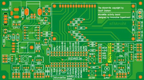

One of the participant (blue shirt) is the publisher of a populr electronics magazine in Thailand.
He also made a experimenter board for the Maximite which will be featured next month.

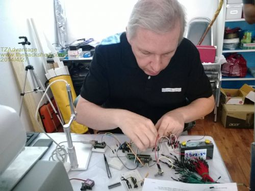

Out of interest, are you in any of the photos?

Yes, let us know if you were pictured in your post (is that you in the black shirt ??). If not get a picture of yourself in the next post.

Out of interest - what's the small vertical gadget with the lead on the little stand in the photo with the 'silver-haired-gentleman'?

Yes i am in one of the pictures. The one with the silver lining. :)

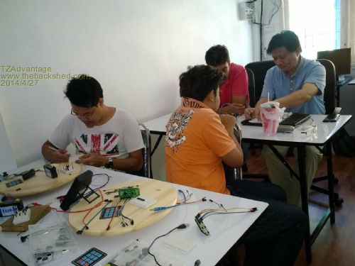

There were 6 persons on each day. This allowed me and an assistant to check everyone's progress and guide them along the way. No blue smoke this weekend.

@Greg, The gadget is a USB microscope. I perticularly like this model as it has a large range. All the way to the top it was possible to have a complete breadboard on the projector. Not the best quality but good enough.I have seen Dave from eevblog do a review of it not so long ago and his impresion was also that it is a good deal.

One of the participants is the owner of a magazine and he will publish a single sided experimenters board next month, in celebration of 50 year BASIC. Here is a preview of the board.
Once it is published (Thai Magazine) i will post it on this forum. It will be very easy to make at home as it is single sided and all through hole.

That experimenter's board has lots of I2C, comms, and power connections capability on it - looks like he's keen on driving a few servos - but why is he using a 250 PIC rather than the 150?

That print was designed and made within two days so that he could take it with him to our workshop. :)
I guess he made a mistake on the silkscreen. Good catch.

I am curious as to which 10-pin module/chip is being used as the USB-to-Uart? Is it a custom unit? Please tell!

Sorry TZA, I should have been clearer - I mean the 10-pin module/chip located on the PCB design from the magazine (you posted a preview of the board).
Posted: 06:51pm 28 Apr 2014
The design had to be single sided to allow making it at home with minimal tools and materials. And it has to be all through hole. Unfortunately no USB to serial chip exists in a through hole package, so putting it on a tiny pcb with headers allows for easy mounting. Also it is then prepared for when Geoff has his VT100 ready, it can be plugged into this connector.
atmega8
