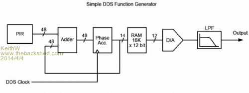

Direct Digital Synthesis is a method for creating any precise frequency at will between wide limits. DDS can be performed in software but not to radio frequencies. There are specialized chips. The chips use a fixed high frequency clock oscillator and are programmed with a 32 bit binary number via a serial interface (SPI). The output is typically a sine wave from an inbuilt A to D converter and Sine ROM table. Once set the output wave will continue without further CPU help until the frequency is changed. Basically DDS requires the repeated addition of a number to a binary accumulator every clock cycle, the most significant bits (14?) of the accumulator address a ROM phase addressed table of a Sine waveform, giving digital values that are converted to an analog voltage by a digital to analog converter. It is possible to use DDS techniques with the Micromite to generate low to medium frequencies, with an external A to D converter or by summing digital outputs with resistors. The waveform could be Sine or anything else repetitive from a table. It is possible to use less than the 32 to 48 accumulator bits detailed here.
Think of the 16K* 12 bit Ram as the ROM sine lookup table in this borrowed block diagram. The PIR register holds the factor needed to generate the required output frequency. If the PIR, adder, and phase accumulator support 48-bit additions, then the fractional frequency resolution is one part in 2^47, or about 1 × 10^14. This provides better than 1 Micro-Hz resolution on a 10 MHz output.

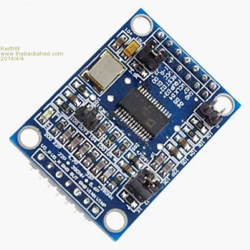

It is possible to purchase an assembled small circuit board with a 32 bit AD9850 DDS with 10 bit A to D c/w oscillator and filter capable of up to about 60 MHz sine output from $12 MiniKits (or EBay $7.80). A DDS can also generate usable output to very low frequencies if the circuit external to the DDS will allow.
