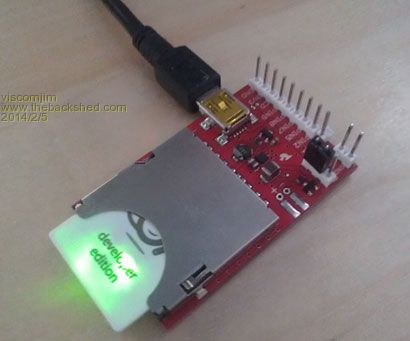

Has anybody tried to get the maximite connected to the internet using either a shield or something like the electric imp, to control things over web? Here is a pic if you have not seen it yet...

I was eager to find out what the electric imp was, when it was in development.
Soon as i found out that you need a hosted service i lost all interest.
Still if you don't mind a dependency it is a nifty thing.
I would like to try out a few wifi and wired ethernet modules to get an internet connection.
Most of them just use a serial port.
