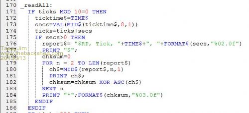

The latest update to MM Edit has a 'Format' command.
Indenting 400 lines of code adds 1k to the file size so there is also a command to remove the indenting.
You can set the indent level between 2 and 8 spaces.
I like 4 but 2 is a better choice for the limited screen space on the Maximite.
The formatting does NOT work on code with line numbers - sorry about that.
I am sure that there will be some layout that I have missed!
Formatting is a very useful way of checking that your loops are properly terminated.
