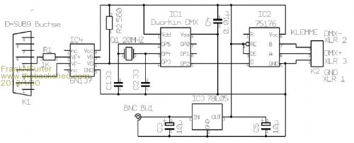

I realized my DMX512 control with a little separate and cheap circuit (Dworkin DMX), but the original site is unavailable - you can found it on the Waybackmachine (http://web.archive.org/web/20090124122934/http://dworkin-dm x.de)
DMX uses 250 kBaud,8,N,2 but Maximite knows only one stopbit... (see my thread: http://www.thebackshed.com/forum/forum_posts.asp?TID=4980)
I build my own circuit with the picture (Schaltplan) on the Waybackmachine and flashed the PIC12F629 with the file "HEX-Datei".
Dworkin DMX supports 80 channels (not 512) on 32 devices.
It works pretty good!!! I control three LED-DMX512-floodlights with my Duinomite and it works very, very good!!!
