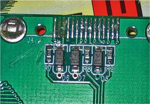

After serveral weeks of operating without any progblems my
CGCOLORMAXI would not display and thing on my monitor
I checked operation of the PIC, working OK.
I downloaded 4.1 again without and problems.
on investigation I discovered that a connection on the
video plug had lifted from the PC board, (2nd pin from the
keyboard end), very difficult to repare.
I fine the video plug used is ver flimsy as it can move when you insert
the video cable. These plugs are generally bulky and weighty.
My CGCOLORMAXI is now a dud unles I can solder new connection to the
PC board and attach a more conventional video plug. I do not think my
soldering skills are good enough.

I have removed the socket with the aim to replace it with and
exteral VGA plug wired back to the PCB.
I may require help from Glen to identify the contacts oon the
board.
There were two track that had come adrift.
The RGB connections and earth are OK though I am not shaw which is R,G or B
as the component numbers differ from the origional schematic on Geoff's web site.
I am not shaw of the two sync contacts on the layout.
No doubt due to the unusual VGA connector used...
You can use a meter to trace the pinout as shown in this PDF layout.
2012-12-30_045150_db15_pinout.pdf

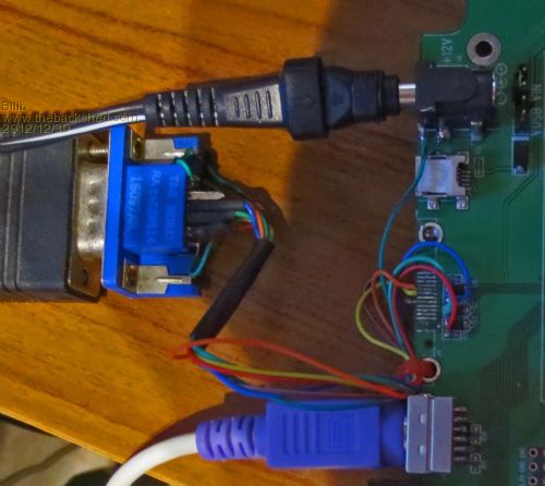

Posted: 06:57pm 29 Dec 2012
Got it working again.
used an old VGA socked from an old computer card and
some fine wire.
Thanks Mick for the advice.

Bill,
Feel for you mate - exactly the same problem with me. The VGA connector bent up when I tipped the board up one time to examine something and popped a couple of tracks. Had to take the VGA connector off and use small fly leads to an external connector mounted on brackets using existing holes. Very poor design sadly for such a wonderfull product.
Mine now working OK but a big *** BE CAREFULL *** to all ColourMax users. The wiring fix is a b#@!*.
Cheers, Panky.
