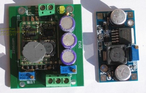

Single supply on the right. The dual supply has a blob of grey rubber on top of one of the inductors - maybe for spacing on the original component?
The dual supply looks a bit kludged. It has a very small (28x25mm) pre-loved piggy back board with dual IR3802A chips, inductors and support SMD passives mounted on it, all sitting on top of a new looking 47x53mm board which mounts the smoothing caps, adjusting pots and screw connectors. The piggy-back control board has had several SMD's prised off at one end! - but both supplies still work, so presumably they were there for something else!
The smoothing caps on the dual supply board unfortunately look rather worse for wear and one of the output ones on the one I received is badly corroded and pitted - it can be seen (centre cap) in the photo above. The output 270uF caps are only rated at 16v for a claimed 1-16v output range too, which is a bit iffy, but if you only want 5v or 3.3v out, I guess OK. (The single supply uses 35v caps). The dual supply's input cap is also only 20v rated for a claimed input range of 7-20v too, but again if you're feeding it with 9v or 12v that should be OK?. I did find though that one of the channels (Ch2) wouldn't work when set at 5v output and using a 9v input - it fired up OK with a 12v in though. The other channel was fine for 5v out with 9v in.
Size-wise, the dual supply board is slightly bigger than two of the single boards so there's not much in that, but the dual supply does have screw terminals whereas the single supply board only has solder pads.

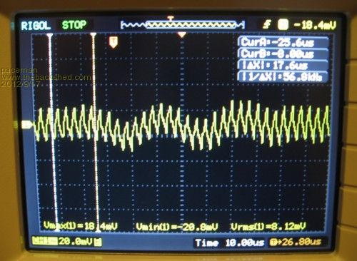

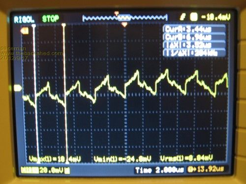

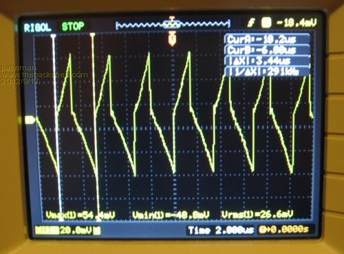

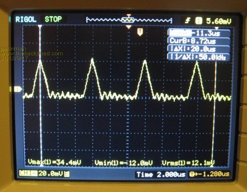

I had a look at the "noise" on each of them - 'scope photos below, all taken at 12v in, 5v out and lightly loaded at 20 ma using a 1K pot. The Vrms of the AC component for each is shown on the bottom right of the screen and the Vmax & Vmin (AC component) are shown at bottom left and middle. There's quite a difference. (Note that the 3802 dual supply runs at 300Khz whereas the 2596 single supply runs at 150Khz.) I included a slower sweep shot of Ch2 of the dual supply because it's AC component had an additional lower frequency, higher amplitude component and this can be seen on the lower sweep rate shot.
Single Supply:
Dual Supply Ch1:
Dual Supply Ch2:
Dual Supply Ch2 - slower sweep:

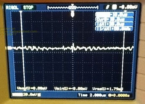

For comparison I also looked at Sparkfun's linear breadboard supply (P/No PRT 00114 - $10). It uses an LM317 and is a single supply switchable for 5v or 3.3v. SF don't quote current capability for this but I guess maybe 1A (?), without a heatsink. The "noise" component is pretty low compared to the others as I guess you'd expect. Physically it's a bit smaller than the others at 30x30mm.
SparkFun LM317 based supply:

They all do the job but I think if I wanted a switching supply with dual outputs I'd go for two of the single supplies because of the better quality of components. If you need the extra current capability claimed for the dual unit then you're on your own. I didn't try to load them up to their current specs - mainly because I didn't want to fry them!
