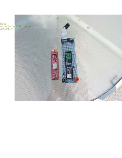

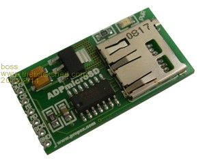

first I would like to thank Geoff for all the time and effort he spent with Color MM development. The result is magnificent and the decision to switch from 64 pin to 100 pin chip is smart. With additional IO pins and integrated RTC module it seems to be capable for industrial use. Because of UBW32 design doesnt have SD and RTC on board I spent lot of time time to find appropriate modules. Especially for SD card, it means the shorter connection is the more reliable the function will be. Finally I found both modules (RTC+SD) suitable to be installed under the UBW board (see picture). All modules are available on Ebay. And it works like charm.
http://www.ebay.ca/itm/DS1307-Based-Real-Time-Clock-Arduino- I2C-Tiny-Size-20x20mm-Any-uControl-/330778120169?pt=LH_Defau ltDomain_0&hash=item4d03e98fe9
Sound was not tested yet because I plan to use a digitally controlled amplifier which is still on its way.
Card detect should be connected to GND
Write protect should be connected to GND or connected to WP switch on front panel
A command for disabling and enabling Ctrl-C function is highly desired to prevent an accidental program interruption.

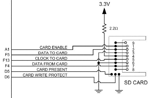

I now have a working SD card on my UBW32
I found on page 5 of the UBW32 manual a circuit to add keyboard, VGA and SD Card and so used the circuit shown there.
