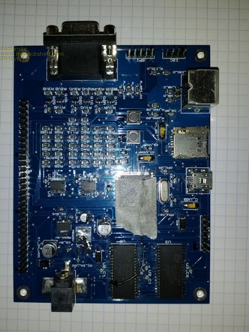

Actually i made a card with external SRAM + R2R DAC and level converter to
be able to put it on a VGA screen.
But ... i made some mistake in the conception and now i wait up i get the
new PCB , then it will be again the hell to solder all little smd components
Here is a photo from the actual design.
After checking if the new design is OK i have to understand correctly
how the DMA / PMP work with the SRAM and video generation ...
And for this , the microchip examples are not really helping me
Cheers.
