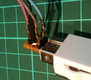

The home-brew adapter is a bit rough, but works pretty well.
You will need a bit of stripboard of the sort that has vertical and horizontal copper strips (although the orginal Veroboard type might work with some ingenuity). You wil also need some single strand insulated wire, and 5 header pins. See below for stripboard I used:
Cut the board so that you have three strips (vertical) at the edge and a couple of horizontal strips. A little bit of sanding and trial (avoid error) and you can get a little board that fits snugly into the Wii socket. The width is about 6mm, but it's best to start a bit wider and sand slightly until the fit is just right. See below:
Next, solder a couple of "whiskers" onto the board. A (blurry) picture tells a lot of words; the main thing to note is that you should leave the insulation intact on the wites and solder one into each of the "horizontal" strips at the edges of the board. Leave enough wire to work with for later. See below:
The next bit involves soldering header pins onto the board. The three pins going into the "vertical" strips at the edge of the board need to be soldered over the wire "whiskers" from the previous step. The pins will only just protrude through the board so thay can be soldered. Two pins are also soldered into the "horizontal" strips in the centre holes. More fuzzy, small images follow:
Almost done. The last bit is a little tricky... The protruding whiskers need to be squeezed into the tiny holes above the slot on the Wii socket. As the board is pushed into the slot, small springy metal tabs move up into these holes and so hold the wires in place. The trick is to get the wires in first before the board wedges the springy metal bits up too hard to get the wires into the gap. It may help to cut the wires to the right length (about the end of the board) and then very carefully, with *sharp* wire cutters, give the wires a chisel edge by cutting them diagonally at the end. It is important that the wires go into the two holes on the Wii socket where the middle connector is Unused, i.e. SCL & GND (image below borrowed from the WiiBrew wiki) and the edge connector part of the board connects to the VCC and SDA lines. The middle of these connections is of no importance to us:
Finally, according to the connection labelled above, connect to your Maximite using some standard female connector leads. Voila:
After all that hard work, grab a cold beer (mind you don't spill it on your benchtop), fire up the Maxi and have so much fun with your Wii Nunchuck that your wrist hurts.
I'll be posting a full Wii Nunchuck Demo program in a day or so.

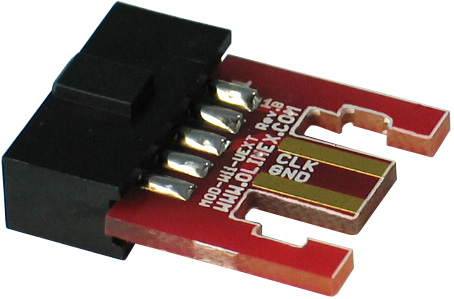

Ken, our first design was like this and it easily slip off the joystick
so we made this MK2 design:
ksdesigns
Joined: 25/06/2011
Posts: 143
Posted: 08:17pm 16 Feb 2012
very nice much better the others keep coming out ..

  Olimex said   Ken, our first design was like this and it easily slip off the joystick
It looks good. Do you sell it? I looked at olimex and dontronics and could not find it. Link?
