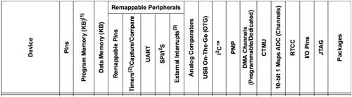

Microchip officially announced a low pin count PIC32 which will be available in DIP package. The data sheet for these new parts shows an upgrade path to 128k flash in the future.
Is 128K too small for the Maximite code?
A 28/40 pin DIP version would make an easy to assemble Maximite kit for students who can't solder a 100 pin TQFP.

As far as I can see the largest version has 32KB flash and 8K RAM which will not support MMBasic. MMBasic would fit into 128K flash but the amount of RAM could be the limiting issue.
Programming the PIC32 is a wonderful experience as it uses 32 bit integers and there are no strange architectural issues that you need to work around. It is just like writing programs for a mini computer.
The PDIP package makes it easy to use the chip as an everyday controller. The only issue is that the MIPS instruction set does use up memory so it could be easy to run short.

The 128k parts shown in the data sheet have 32k RAM.
The chip also runs slower at 40Mhz instead of 80Mhz.
And only the 28 pin is PDIP.
Maybe this can be the Maximite-Tiny in the future.
