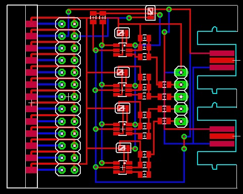

Still have not rotated the screen yet but has sound and is fully playable
just need to get it rotated.
not real happy with the sound playing wav files thru pwm .
so i figured i would make a board with a dac on it to play wav files
did a rough design and added 4 12bit I2C DAC's and 2 Wii Controller ports
has 26 pin edge connector to plug in to the maximite so you don't need a cable
will try and build one this week
ken

ksdesigns
Joined: 25/06/2011
Posts: 143
Posted: 03:29am 28 Sep 2011
It uses a microchip MCP4725 DAC
• Fast Settling Time of 6 μs (typical)
• External Voltage Reference (VDD)
• Rail-to-Rail Output
• Low Power Consumption
• Single-Supply Operation: 2.7V to 5.5V
• I2CTM Interface:
- Eight Available Addresses
- Standard (100 kbps), Fast (400 kbps), and
High-Speed (3.4 Mbps) Modes
• Small 6-lead SOT-23 Package
• Extended Temperature Range: -
so its good for a lot more than audio
that's why i added 4 of them :)
and for the Wii controller you can use the classic one for games
or the numcuck one you get a joystick and a
STMicroelectronics LIS3L02AL 3-Axis MEMS Inertia Sensor
ken

Posted: 08:23pm 28 Sep 2011
Would you be able to post a circuit diagram of the sound/game controller module? I was going to design one so I could use the Maximite as a sound synthesiser. As for colour graphics there's a module (the PICASO) that you can get from Sparkfun that lets you send it serial data and draw stuff on the screen. Here's the link: http://www.sparkfun.com/products/10329. It's about US$59.95, though, so it's a bit of a pricey solution.
Capacitance is futile - roll on 2012!
ksdesigns
Joined: 25/06/2011
Posts: 143
Posted: 09:51pm 28 Sep 2011
i will post on when i get it done this week
if you want a easy way sparkfun sells a breakout board for the dac
Sparkfun MCP4725
for about 5$
ken
