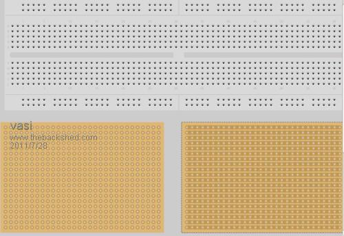

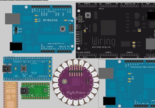

The most interesting of them is Fritzing, with suport for almost all microcontroller boards form the market (Arduino/Basic stamp/Picaxe area).
It supports three major boards, Breadboard, Perfboard and Veroboard(here you can cut traces to suit your schematic):

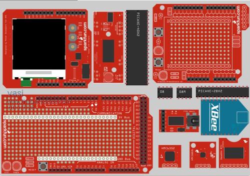

Arduino, MBed, Wiring, Basic stamp, and other boards:
All Picaxe chips with their accessories and all Sparkfun board support (breadboards, sensors, etc.):
Perfboard area from those boards is interactive, you can place components...
Also, all important components required to complete our projects.

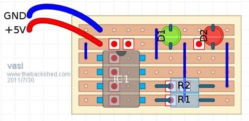

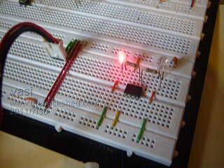

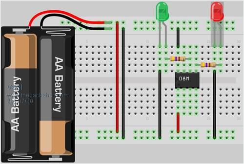

The best way in getting familiar with it, is to start a little project. So, I started blinking two LEDs with a PICAXE 08M and this is how it looks on the breadboard:
The battery from image have two cells but we need a source between 4.5V and 5V. Also, the required components for serial connection are not used here, we suppose we programed already our chip.
On my breadboard, doesn't look as on project image but is electrically correct:

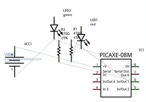

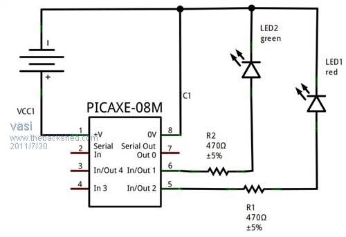

At first, schematic look bad, you have the components randomly placed and you must drag/rotate them and to make connections:
It is a little tricky but you can manage to get what you want (as I said earlier, you can skip this part if you don't need to present your schematic, or have a better tool for this):

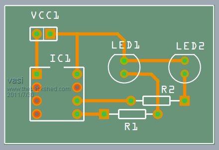

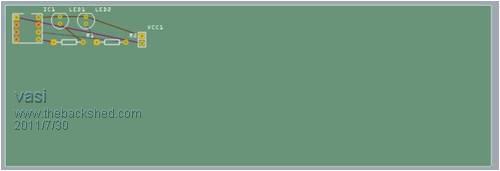

The same thing applies for the PCB (if you want to have a final PCB for your project). components are placed o a large board and you must resize it and make your traces:
On "View" menu, you can find options for setting the grid and align to it. Drawing traces, is as tricky as in schematic editor but at the end you can make a nice PCB. It is helpful to activate the "Layers" panel from "Window" menu. Anyway, I didn't explored all features...

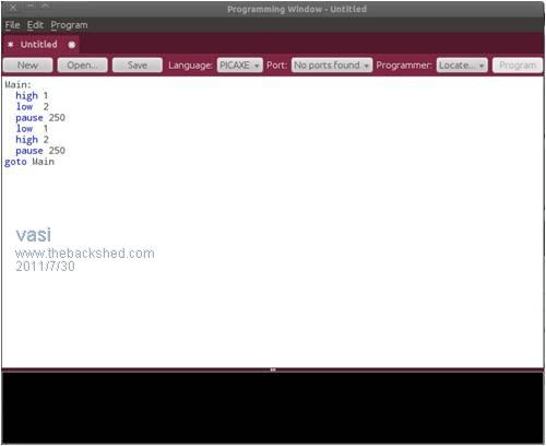

The good news for PICAXE users is that Fritzing have a programing window which is supposed to program your chip. Didn't explored this, I fried my PICAXE 08M long ago (about this, read below):
This is the result:
http://www.youtube.com/watch?v=kstfZpydbjY
I used a PC power source - be careful at connections, better use diodes to protect the chip if you reverse the polarity.

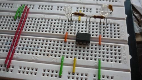

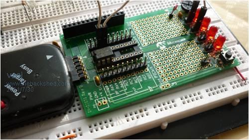

Note: This post wasn't intended as a true tutorial but only as an illustration of what can be done (well, a small part from what the program can do). Also, as I said, I didn't had a PICAXE but I used a 12F629 chip, along with my Pickit 2 programer and his testing board:
The program was written in Oshonsoft Basic.

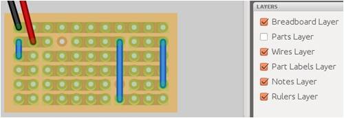

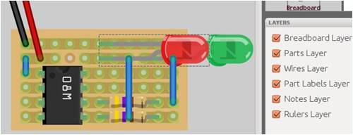

I found the way to see the veroboard cuts on Fritzing and is related to layers:
As you can see, in this area Fritzing still has a lot to do (veroboards and perfboards were added recently). First, it doesn't have yet the proper graphical components for these kind of boards. Second, it has problems in drawing the board at small dimensions (look at the offset on the strips from the bottom of the board).
But is still great because any modification you make on veroboard, is automatically reflected on schematic so you can check your work at every step. No other program can give you such a feature (or I don't know about).Edited by vasi 2011-07-31

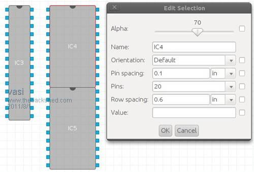

Working with DIY Layout Creator I found a limit at a maximum of 32 pins for a DIP IC. The workaround is to use two ICs with 20 pins and 0.6in spacing to simulate a 40pin DIP microcontroller:
If the black line from the middle of DIP capsule interfere with your design (a resistor, wire, cut or jumper is placed there and you can't see details) then chose other combinations, an extreme one having 32 + 8 pins.
