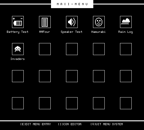

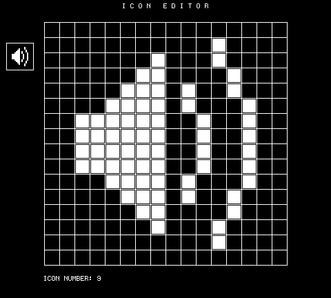

I'm about to release my menu program, "Maxi-Menu".
Just a few small things to tidy up and it will be available for download.
Here are two screenshots. The first is the main menu page and the other the built-in icon editor.

Posted: 10:27pm 24 Jun 2011
Works a treat Nick, well done.
Invaders?
Nick
Joined: 09/06/2011
Posts: 512
Posted: 10:35pm 24 Jun 2011
Invaders...in preparation for Bob's Space Invaders game he's writing. :)
They're only mockups just to use as examples. The program doesn't acually check what programs you have on your SD. The user can make whatever definition he wants in the menu, it will just go to the BASIC prompt if you try an execute and entry that doesn't exist. :)
If we had programmable characters, invaders could be defined and that would make it a lot easier to program.
