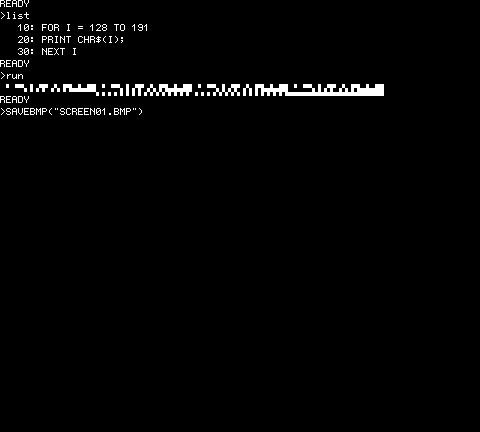

1) I have implemented Graphics Characters for CHR$(128) to CHR$(191) this give compatability for the TRS-80 / System-80 Basic Character set.

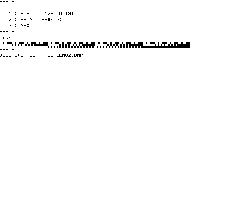

5) I also wanted to be able to flash the screen very quickly, so I extended the CLS command to take an optional argument. 'CLS 1' for fill with White, and 'CLS 2' to invert the screen.

See attached screen shots.

Now the inverted video.
