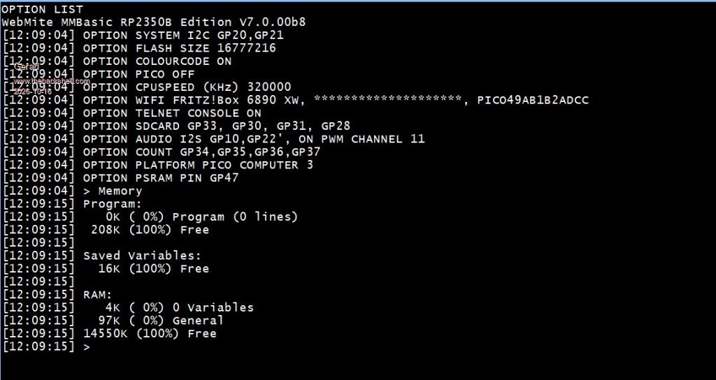

What do you think of the 16MB fix? The fix was created by “Claude”
PicoMite / WebMite 7.00.00RC2 - fixes for the RP2350 PSRAM builds
Files
 7.00.00RC2-Retime.patch  PSRAM timing after a run-time clock change (CPU SPEED, RESOLUTION)
 7.00.00RC2-Heap.patch    ERASE etc. never freed a block on a heap's first page
 7.00.00RC2-16MB.patch    optional: 16 MB PSRAM for WEBRP2350 and HDMIWEB
 CLOCKTEST.bas            test for the retime fix (CPU SPEED through 126..320 MHz)
 HEAPLEAK.bas             test for the heap fix (WebMite, 304 KB SRAM heap)
7.00.00RC2-Fixes.zip
WEB-7.00.00RX-16MB DEMO.zip
