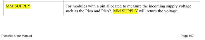

It's in the manual MM.SUPPLY

print mm.supply
0
returns 0

  Quote  For modules with a pin allocated to measure the incoming supply voltage
such as the Pico and Pico2, MM.SUPPLY will return the voltage.
