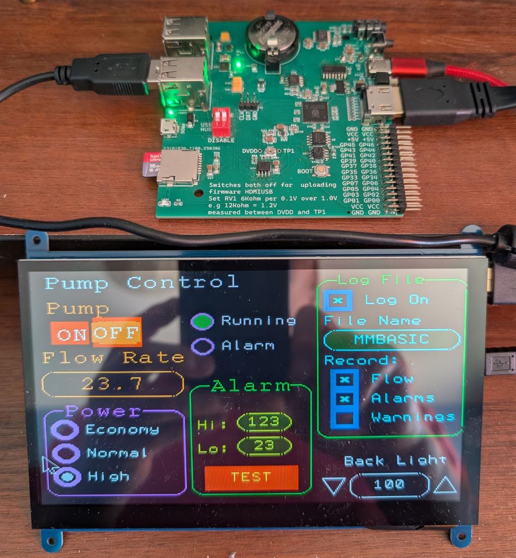

No freaking WAY!
Wait, does this mean that a desktop PC monitor with USB touchscreen will work?
I'm all of a dither...need to grab a coffee
Capacitive

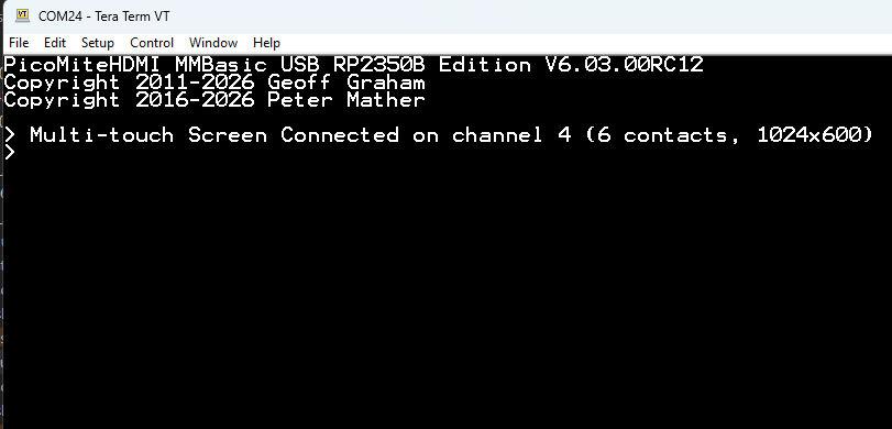

  Quote  Watching this thread with interest.
Coming soon
 Select Case Touch(SWIPE)
   Case 1 : Print @(0,0) "swipe LEFT     "
   Case 2 : Print @(0,0) "swipe RIGHT    "
   Case 3 : Print @(0,0) "swipe UP       "
   Case 4 : Print @(0,0) "swipe DOWN     "
 End Select
 If Touch(TAP)   Then Print @(0,16) "TAP            "
 If Touch(DTAP)  Then Print @(0,16) "DOUBLE TAP     "
 If Touch(HOLD)  Then Print @(0,16) "LONG PRESS     "
 Select Case Touch(PINCH)
   Case 1 : Print @(0,32) "EXPAND         "
   Case 2 : Print @(0,32) "CONTRACT       "
 End Select
 Select Case Touch(ROTATE)
   Case 1 : Print @(0,48) "ROTATE CW      "
   Case 2 : Print @(0,48) "ROTATE CCW     "
 End Select
 If Touch(TTAP)  Then Print @(0,64) "TWO-FINGER TAP "
 Pause 50
Loop

Very nice! Is the 1024x600 resolution supported natively or is the display up-scaling or re-scaling a different resolution?
Posts: 12037
Posted: 04:50pm 28 May 2026
  Quote  Is the 1024x600 resolution supported natively
Yes. OPTION RESOLUTION 1024x600
mode 1 1024x600x1-bit
mode 2 256x150x4-bit
mode 3 512x300x4bit
mode 5 256x150x8bit
That was in 6.02.01 but somehow missed the manual
