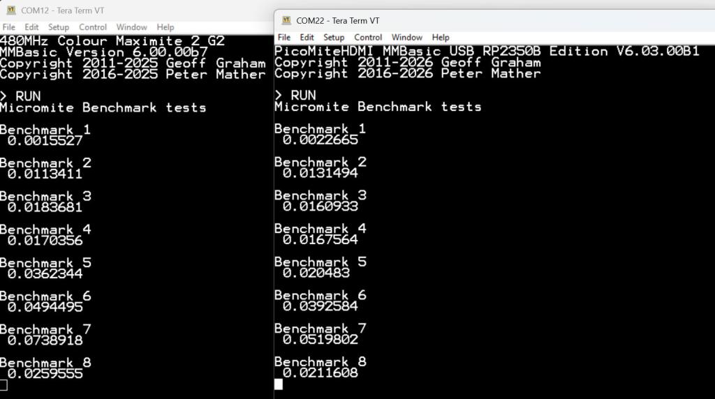

Here is the result with the PicoMite without the bytecode optimiser
  Quote  Benchmark 1
0.0022644
Benchmark 2
0.0180988
Benchmark 3
0.0288411
Benchmark 4
0.0262077
Benchmark 5
0.0738827
Benchmark 6
0.0926415
Benchmark 7
0.126989
Benchmark 8
0.0377242

Posts: 6187
Posted: 06:40pm 24 Apr 2026
Peter,
The first post shows cmm2 and non optimized pico results. What are pico optimized results.
Posts: 2994
Posted: 08:30pm 24 Apr 2026
  Volhout said  Peter,
Right hand screenshot is the optimised timings (as I read it!)
