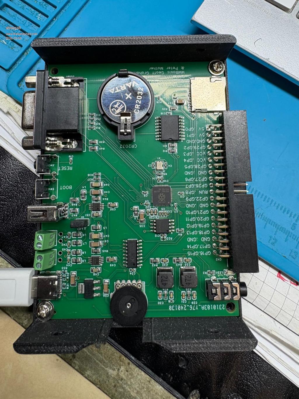

Hallo,
which USB Port should i connect to power it on, USB C or USB A?
Which Button to Press when Flash?
Boot or Reset?
The Device doesn't show up in my Explorer to copy the Binary on it.
RED on board LED is blinking.
THX
Posts: 12040
Posted: 05:42pm 05 Feb 2026
A to program. C to use at which point the A becomes a USB host. Use the VGAUSB firmware.

the RP2040
or RP2350?

If i copy the PicoMiteRP2350VGAUSBV6.02.00.uf2 file on the RP it will not reboot.
Also the Clear Flash tool from Geoff will not work/reboot
No serial console will be shown in device manager.
No idea what i can do now.

RED Led is blinking slowly
atmega8
Joined: 19/11/2013
Posts: 738
Posted: 10:36am 07 Feb 2026
Seems to be ok now.
Hardware/OS  Problems with my usb  under win11.
Crashes, freeze...
so there is a rp2040 on the board?!
> print "hello"
hello
PicoMiteVGA MMBasic USB RP2040 Edition V6.02.00

atmega8

Is the a documentation for the board for setting the correct hatdware options for I2C RTC etc...?

With the USB firmware running you can plug a non-powered USB hub into the USB-A socket. You can then run a mouse and keyboard and, optionally, some USB game controllers.
I can't quite read the numbers on the Raspberry Pi chip, but it appears to be a RP2040, as expected, because MMBasic seems to be running ok.
I haven't got one of these boards so I might be of limited help.
Posts: 3412
Posted: 10:55am 07 Feb 2026
  Quote  Is the a documentation for the board for setting the correct hatdware options for I2C RTC etc...?
I think the configuration options are printed on the bottom of the board.
The name of the design may be there too. If so you can use that to search the forum for more information about it.
Posts: 9224
Posted: 11:03am 07 Feb 2026
I've been trying to find the documentation on this board but I've no idea where it is now.  :(
Posts: 3412
Posted: 11:21am 07 Feb 2026
I think this is the one.
https://www.thebackshed.com/forum/ViewTopic.php?TID=16632&PID=217114#217114#217114
Posts: 9224
Posted: 11:31am 07 Feb 2026
That looks like it, thanks Phil. :)
I see the options are nicely listed on the bottom of the board and on the display in the pic. :)
I told a lie too - I did get one of these. :) It's the one I made to look rather like an Apple device. :)

Updated to latest firmware now. :)

Thanks to all
Its up and running...;-)
Nice Board from Peter, also thank you again for everythimg you are doing arond mmbasic.©©©©
