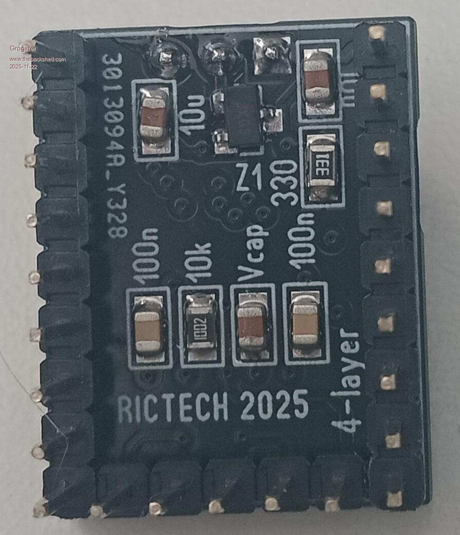

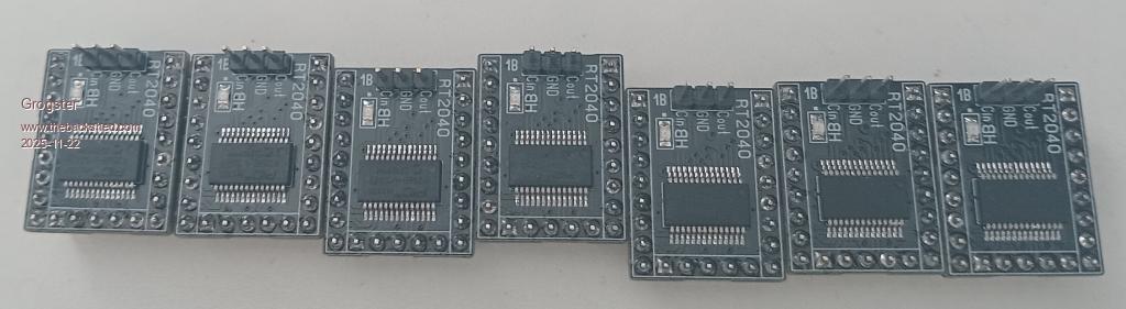

The oven is the 962A - the latest version, that incorporates changes and suggestions made by many people who bought the first gen oven.  Specifically, the "A" version has a heat-blanket-insulation-thing installed around the inside of the internal of the oven, rather then the standard insulation and masking-tape of the first gen units - that used to burn that tape and make an awrful smell.  The new unit also has a better controller and more accurate thermal profile, and the fan at the rear is also now baffled.
As far as the hotplate, I set that to 155'C, and preheat any PCB first, and then attack it with the hot-air station set to 220'C, airflow set to #2.  I can solder eight or so of the RT2040 PCB's in about 90 seconds once pre-heating has completed, and I attack them with the hot-air wand.
The components MOSTLY self-align as you would expect once the solder-paste flows, but I have had the odd cap misbehave during the first pass.  To correct, just apply more hot-air, and give the cap a wee poke with the end of my tweezers(keeping my hand OFF the hot-plate!), and it re-self-aligns and reflows - visual thing of beauty to behold.
