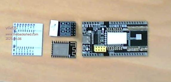

below are some pictures of the modules in use:
left side: ESP12F adapter to 2,54 mm
middle top: ESP01+ with 10-pin header
middle-bottom: ESP12F SMD module
right side: universal programming adapter for ESP01+ (yellow header) and ESP12F (can be inserted into the spring contacts). After soldering into the adapter only some jumper wires help to reprogram the ESP12F, of course ....

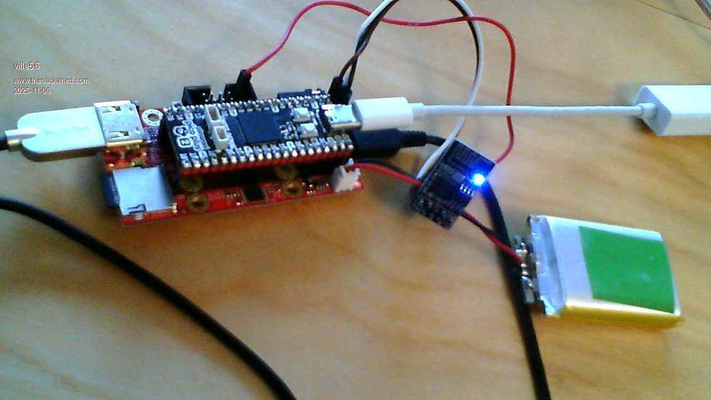

My test-setup with a Pico HDMI and a ESP01+ adapter
