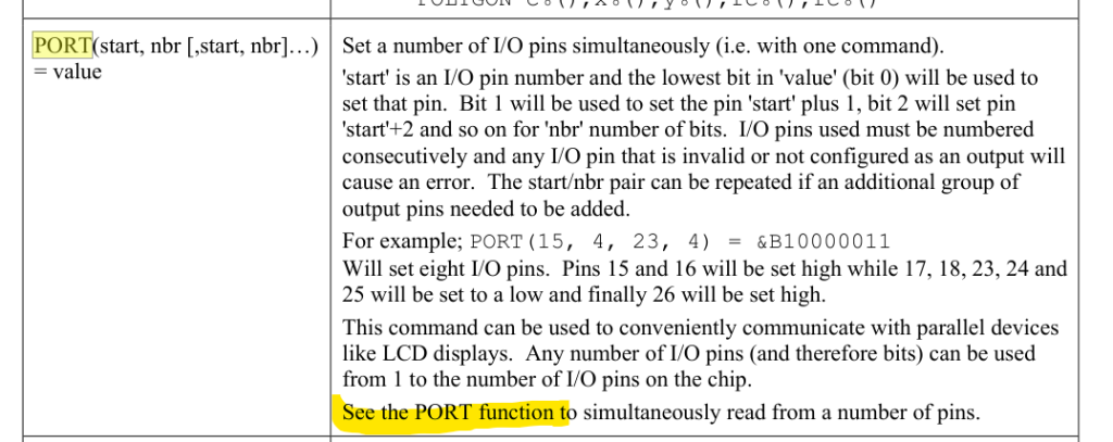

Posted: 02:29pm 03 Nov 2025
Without knowing what you need to achieve, can't you make PORT work?
