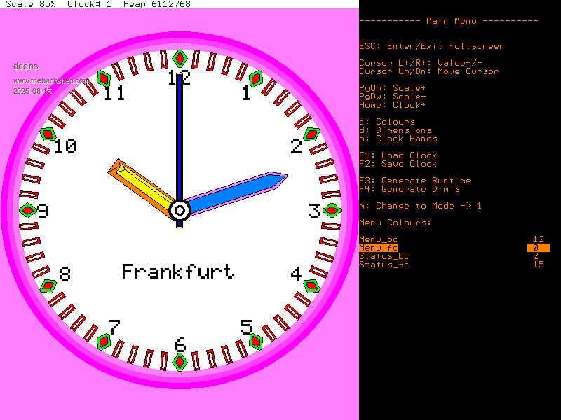

Hello :)

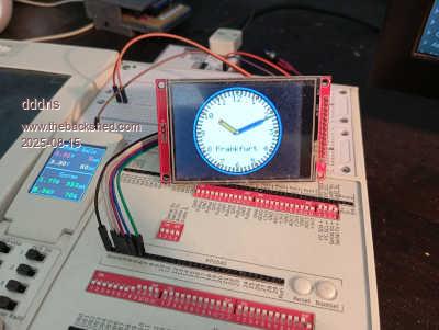

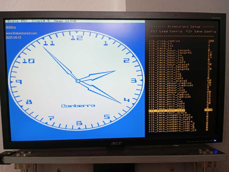

I have written an UI to build an analog clock with various elements. All the parameters can be setup with this, at the moment there are 5 designs which can be altered as you like. There are 3 sections for dimensions, colours and the clock hands. Every section can be saved to disk or the whole object as a snapshot.
Once you are finished it can be exported as a running basic program with an empty main loop, or only the DIM statements can be generated.
It runs on a 2350 in any resolution for MODE 1 and 2 and it runs in any MODE with resolution 1024 and above.
The program is too big and cannot be loaded from disk in Resolution 800 or 848.
Please test it and leave a comment what you think.

To generate a runtime, a copy of "VGAcD.bas" needs to be on root of A: drive.
The extract will run on RP2040 with ILI9341 or with OPTION LCD320 ON on all others:

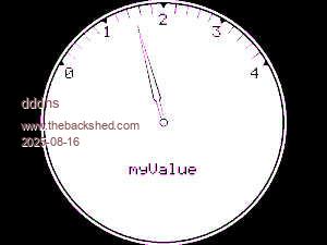

I've corrected a small issue and now the runtime contains some lines of demo code how to use it as a gauge:
edit:
I removed the old zip, this is the new one. Switching between Modes works now correct.

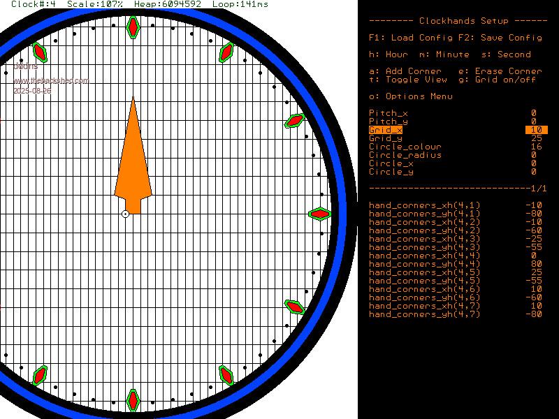

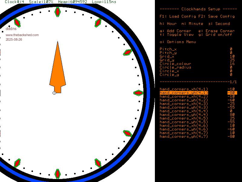

I have written the routines for:
- adding a corner to a hand. Corner is inserted below the cursor position and is a copy
 of it. A pitch can be set which will be added to the new coordinate so you can set
 them in a row.
- deleting a corner
- visualizing the corner of the current cursor position with a marker
- displaying a grid
All other routines are reworked and error handling is done.
The extracted dim's need to have the drawing library which needs to be installed first and is included in the zip.
VGAcD.zip

Hello Amnesie,
thanks for your reply!
I have tested it in every resolution with VGA and HDMI firmware. It runs almost in every resoltion there is and fonts still fit and dimensions are kept. Please try it in Resolution 1280 and Mode 3 which looks not too bad. Of cause it looks best in Resolution 800 Mode 3, but this is only possible with PSRAM..
How to use it as a gauge you can see, when you create a runtime.
At the beginning you will find a line:
dim integer gflag = 0 'set to 1 to use gauge mode
Set it to 1 and follow the next lines of code and see how to set the value and the labels and gauge scale.
In order to create a runtime version of a clock, the file VGAcD.bas must reside on disk.
Best you create a subdirectory on A: or B: and change into it with chdir. Then copy VGAcD.bas to it and start it from that directory. All files config will be read and written from/to this and you don't have a mess in the root directory
Edited 2025-08-26 02:44 by dddns

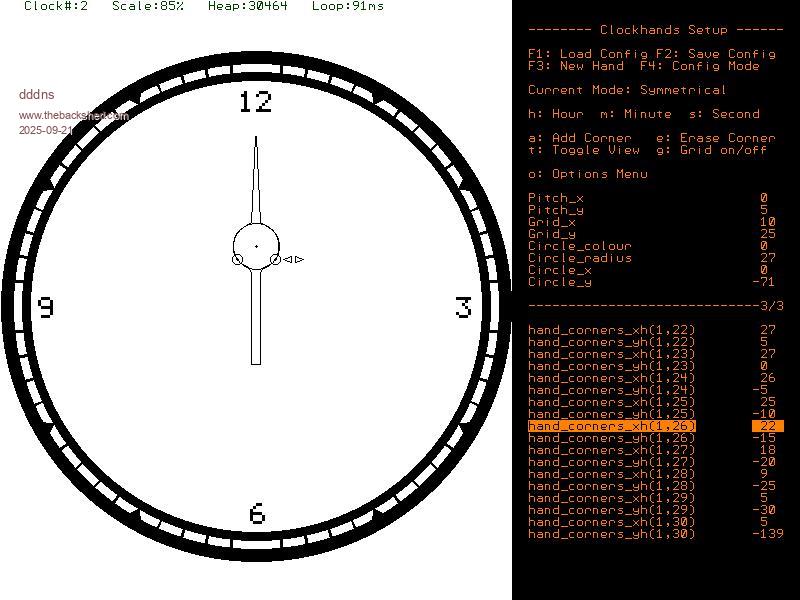

Posted: 03:50pm 20 Sep 2025
Hello :)

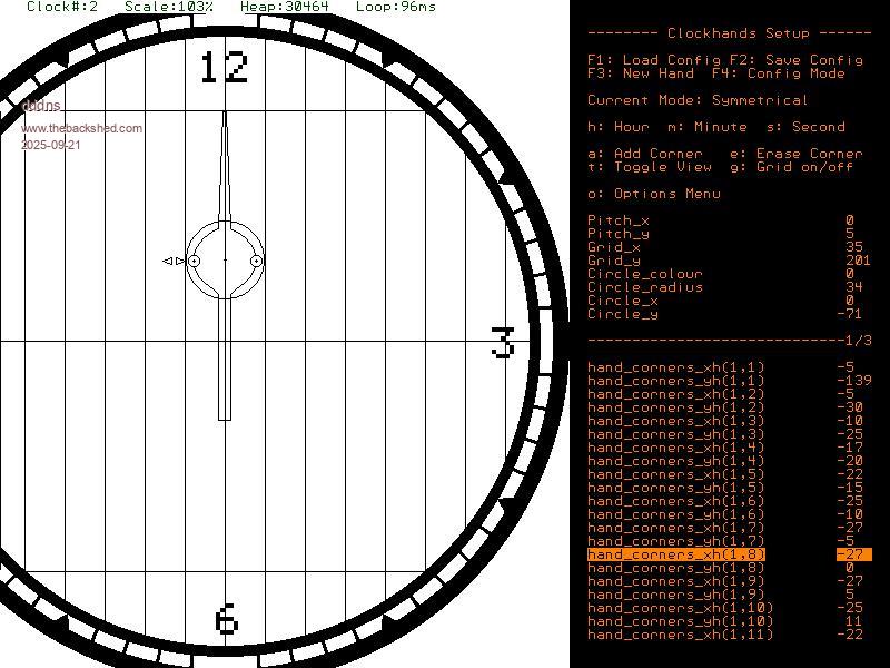

One of my goals was, to have clear variable names and not cryptic multi dimensional arrays as the runtime extract is my focus. A second one was to have all these variables manageable as easy and clear as possible.
I needed the program space to realize all of that while still fitting into internal editor as this is my preferred debugging tool. It must not exceed 95Kb so the step to convert it into disk-based was necessary. With the gained space I did some roundups
and have added another way to setup the polygons for the hands. and that is symmetrical. Symmetrical built hands have an even number of corners and the coordinates are set paired/mirrored. That makes it much easier:
I've set the pitch to 5 pixel and created 15 pairs of corners. Then the constrution helper circle can be use to align all these corners row by row at the circle:
this is a bit sloppy but can be done pretty accurate
VGAcD_disk3.zip
I orientated myself on this  and never looked for more. I haven't worn a watch for 30 years :))
Edited 2025-09-21 02:22 by dddns

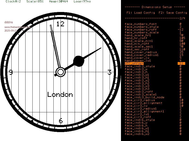

Posted: 12:51pm 22 Sep 2025
Hello!

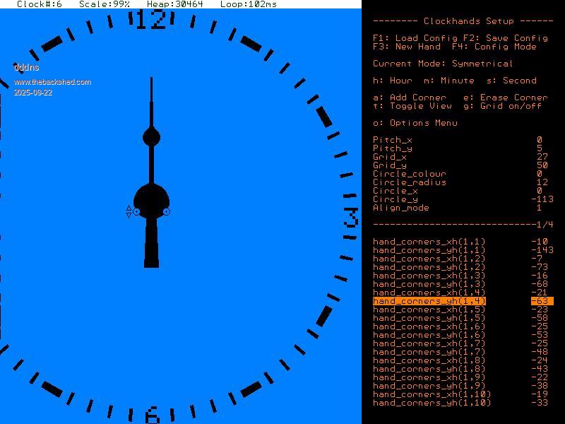

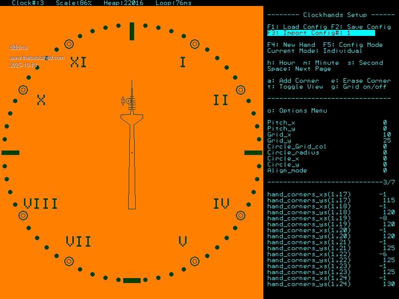

To make it easier to have nice round shaped hand I implemented a auto-align mode.
All coordinates within the construction circle are automatically aligned but only in symmetrical mode. You can adjust the position in y and the radius. If the coordinates are set in a row with a pitch of 5 pixel, the circle looks good as can be.
This example is done with 20 pairs of coordinates but I've tested 72 cornered polygons which also work very nice.
Also many corrections and polishing including the designs itself.
VGAcD.zip

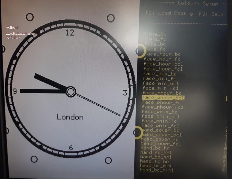

Posts: 6187
Posted: 06:58am 24 Sep 2025
Hi dddns,
Played with your V1 version a bit. Impressive how configurable this is. It could think this is a nice challenge for the forum "Who designs the nicest clock".
I used your version on a 2350VGA platform with PSRAM.
During my experiments I was able to surface a bug. See photo. Some of the hour markers are drawn into the menu, and are not erased anymore. Not even when you exit the menu. See the yellow circles in the menu.
Thanks for this nice program.
Edited 2025-09-24 16:59 by Volhout
dddns
Joined: 20/09/2024
Posts: 924
Posted: 10:21am 25 Sep 2025
Hello Volhout,
many thanks for testing and your feedback.
I´m aware that all markers and the numbers can be set with their offset out of bounds of the drawing area. If the menu is redrawn when something is printed in this area then a flickering effect will happen which looks not nice. This would happen within the same frame and thus also with framebuffer.
I was not sure in the beginning how to best handle it and in the end I forgot..
I think the best solution is whether not to print the affected labels and this would be not easy to do. Or to scale down the rest according to the radius the most outside positioned label resides on..
dddns

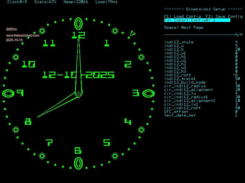

Posted: 06:51pm 12 Oct 2025
Good evening!
I have rewritten large parts of it. All static data is now read and written to/from disk and that works very nice and fast. The way polygons are setup is now easier to handle. No object can draw beyond the menu line any more. With space the page can be turned and with F3, dimension and colour and a single hand can be imported from any existing.
The numbers and text can have auto scale now with every font, Font9 is included.
I've update the designs and there are 11 now to have a start with. The performance is increase and I took care, that really only code what is necessary is executed. The hand can have up to 62 corners.
This is still a test version. So please have fun and test it :)
VGAcD_new.zip
