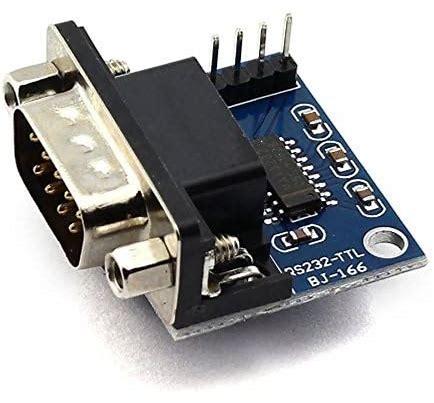

I use that printer with a Pico 2W and it works fine. I use a TTL to RS-232 converter such as this one:
Once that MAX3232 adapter is connected to the Pico, what is the cable layout to the printer? Do you need to take into account the CTS pin and the voltage of the printer connector?
I use a straight-through connector. I have a 9-pin to 25-pin adapter on the back of the printer and a gender changer since the adapter has a female 9-pin side and the cable I use to connect to the MAX3232 needs a male. You connect the Vcc and Gnd connectors on the MAX3232 to the PicoCalc. Connect the RXD and TXD lines to the corresponding GPs. If you get no response, switch RXD and TXD. It's that simple.

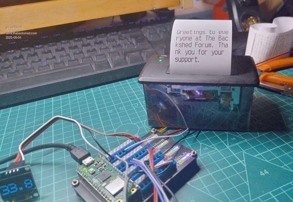

Posted: 06:30pm 03 Aug 2025
The simplest solution is the best.
The printer's RX and TX lines are reversed, as they said on AliExpress.
I connected only the TX line, pin GP4, and ground from the Pico. At 9600 baud via COM2, printing was successful.
Thanks for the replies.
Best regards.
