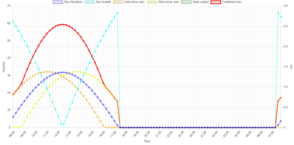

  Quote  PRINT thistime$,STR$(p1,2,3),STR$(p2,2,3),STR$(p1+p2,2,3), _
STR$(SUN.solarElevAng,3,1)
Time, power for first array, power for second array, total power, sun elevation.
I use a version of the code to produce this:
