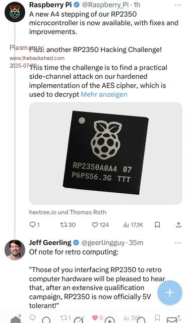

Rp2350 A are now 5v tolerant
Rp2354 has now 2 MB on chip flash
And a new SDK

Be careful with the 5V tolerance - THERE IS NO CHANGE
See the release info
It is just a documentation change. THE RP2350  MUST STILL BE POWERED BEFORE 5V IS APPLIED TO ANY OF ITS PINS.

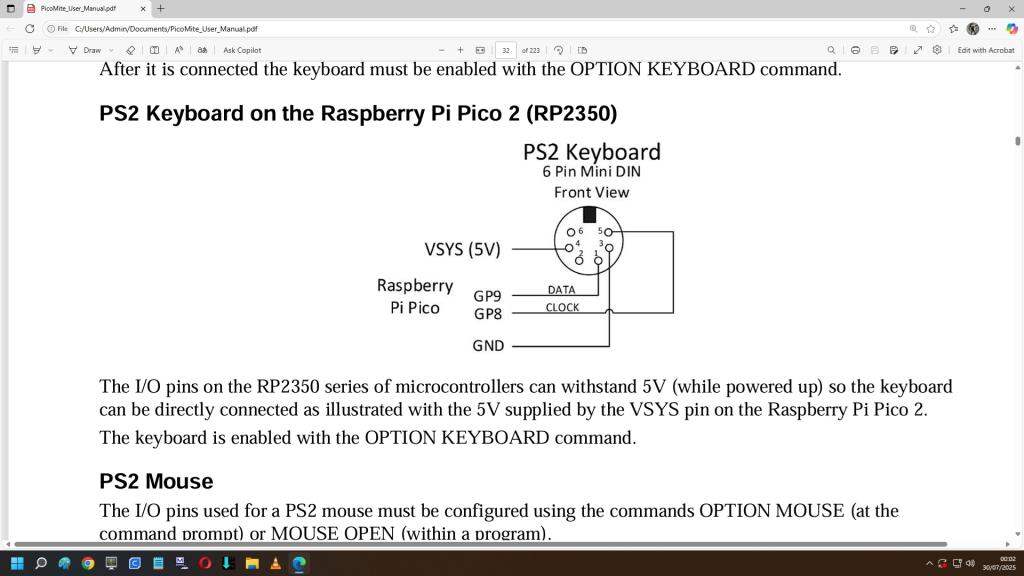

It will withstand 5V on the GPIO pins PROVIDING THAT THE PICO IS POWERED UP FROM AT LEAST 3V3. You can't safely connect 5V signals if the Pico is unpowered as you'll damage it. So it's NOT TTL compatible, it's 5V tolerant under specific circumstances.

Where you have to be very careful is with a USB-TTL converter when you are using a USB version of the PicoMite firmware. The pullup resistors on the data lines are often to the 5V supply from the USB port so you mustn't connect them to a PicoMite unless you either fit level shifting or can guarantee that the signals will never exceed 3V6 at the absolute max. Some converters allow you to select 5V or 3V3, but test them before you connect as those links don't always do what you expect!
