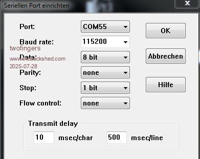

When I use the PC keyboard with Teraterm (v4.85) on the PicoMite, I regularly get incorrect (ghost) characters like "[A" or "[B" in the text when I move the cursor keys (not very slow) across multiple lines in the editor, making this input method useless. It reminds me of incorrect input characters on the Maximite many years ago.

the escape codes for PUP and PDOWN are esc [ A and esc [ B. That means somehow you are losing the esc or alternatively there is too long a pause between the esc and the [ character. Do you have a inter-character pause set up in teraterm? You shouldn't need one but play with this and see what happens.

I've set a 10 ms transmission delay for years (since Maximite). I'd somehow come to terms with it.
I've now set the delay to 0 ms, and everything works perfectly, as far as I can see! I'm very happy!
