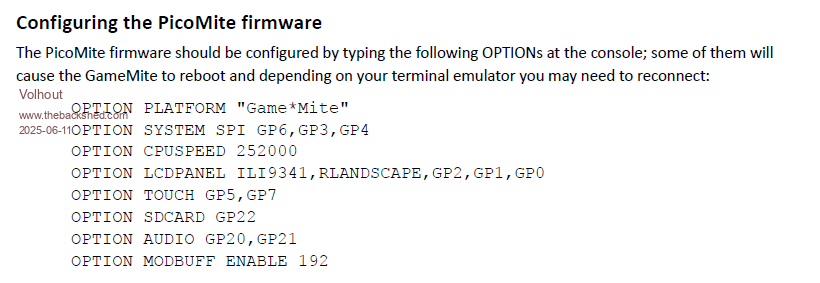

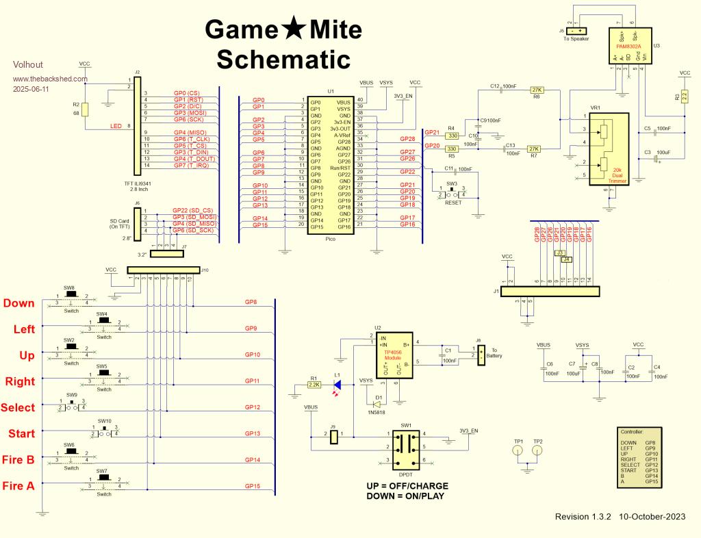

Posts: 6187
Posted: 08:00am 11 Jun 2025
Hi tenij000,
Below is a schematics, and associated OPTION settings where the PicoMite connects to a SPI LCD, and SPI SD card, and SPI TOUCH, using a ILI9341 panel.
This is copied from the Game*Mite.
Your hardware may connect different to different GPIO pins, but this should get you on your way. Note that the SPI pins (MISO/MOSI/SCLK) must be connected to a SPI pair on the PicoMite.
Thank Tom and Mick for designing this.
Posts: 9224
Posted: 08:17am 11 Jun 2025
VCC, GND, SCK, MOSI and MISO are common to all three. They are three separate devices on the same SPI bus, but each has additional pins for it's own use.
The display requires CS, RESET, DC and LED
The SDcard requires SD_CS
Touch requires T_CS and T_IRQ
You can actually use any combination of the three devices by just connecting the required pins. If you don't want Touch then simply don't connect T_CS or T_IRQ and don't use OPTION TOUCH to configure it.
Additionally, the SDcard can optionally use its own SPI bus or a "bitbanged" SPI that can use any available pins but has slightly lower performance. It may as well share the display SPI though as you only need to supply a pin for SD_CS.
(Not this Mick for the above design. :) )
