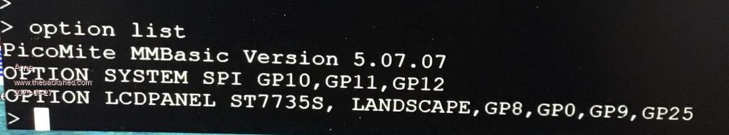

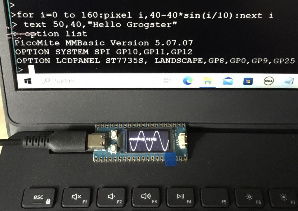

So, can you CONFIRM that the controller on these WS modules, is the ST3375S?
Arne
Joined: 05/01/2025
Posts: 64
Posted: 08:00am 27 May 2025
With my configuration it is working.
Arne

  Arne said  With my configuration it is working.
Arne
"Hello Grogster"
Nice one, my son.
Did not spot that on the first time through the thread.
I will order a couple on my next WS order then.
