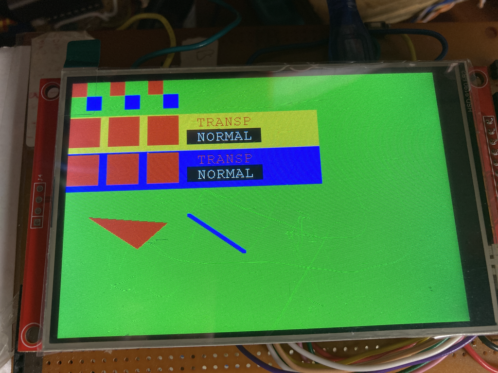

This is my test program result.
The first column is the source.
Next column is result of BLIT READ / BLIT WRITE
Next column is result of a BLIT.
Next is TEXT and Transparent Text
Triangle and LINE AA I think call ReadBufferSPI as well.
Various subtle things occur when it not right.
e.g. BLIT and BLIT READ/WRITE can give incorrect colours.
It seems to be correct with the two changes above.
Maybe its worth printing out the chip ID and see if its different from yours.
The test code is below.

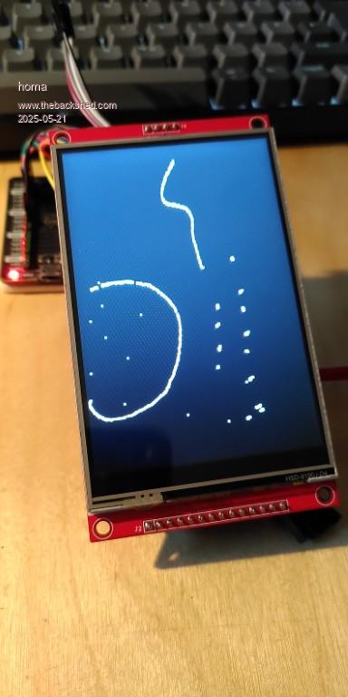

OK, my ST7796S display has arrived. Which pins are best to use with the Pico? Do you have any recommendations, Peter?
OPTION LCDPANEL ST7796S,orientation, DCpin, RESETpin, CSpin [,backlightpin] [,INVERT]
I don't have a pin header soldered into J4 yet, but I need to do so for SD card use, don't I?
Otherwise, could you just provide me with your option list? I'll try to make sense of it.
Thanks in advance.

I think I have stumbled on the solution for not requiring the delay.
On the Armmite I have it working with #define ST7796Schangetowrite  1
i.e. 1 uSec. I have not pulled out all the code for the delay but I suspect its not need at all.
P.S. All delay code removed and its still good!
    also removed from Picomite RC23 and recompiled. All good.
The fix is to bypass D1 in series with CS on the board as covered in the post below.
I added jumper J1 (for 3.3v) as well at the same time so not 100% sure which fixed it, but suspect its the D1 bypass.
Extract from post.....
Some ST7796 (and ILI9486) displays have a diode inline with the TFT chip select. This is a board design error as there is nothing the other side of the diode to pull the TFT chip select high. If there are other devices on the SPI bus, such as a touch controller then this diode is likely to cause problems.
It would affect how long before CS wanders to the high state, so we needed a delay to ensure CS went high after the read, before it was pulled low again on a write.
Link to solution

OPTION CONTINUATION LINES ON
OPTION CPUSPEED (KHz) 378000
OPTION DISPLAY 55, 155
OPTION LCDPANEL ST7796S, PORTRAIT,GP15,GP14,GP13,GP7
OPTION TOUCH GP12,GP11
GUI CALIBRATE 1, 154, 3980, 863, -1279
OPTION SDCARD GP17
OPTION RTC AUTO ENABLE
> gui test lcdpanel
> gui test touch
> RUN
ST7796S Test by disco4now 19-05-2025
F80000  RED F80000
F80000
1CC0    GREEN FC00
1CC0
F80000  BLUE F8
F80000
F80000
F80000  BLUE F8
F80000
F80000
F80000  BLUE F8
F80000
F80000
F80000
1CC0
1CC0
F80000
1CC0
WRITE TIME:      0.684
1CC0
F80000
BLIT TIME:       16.948
CLS TIME:       0.104
Using Peter's last .uf2
