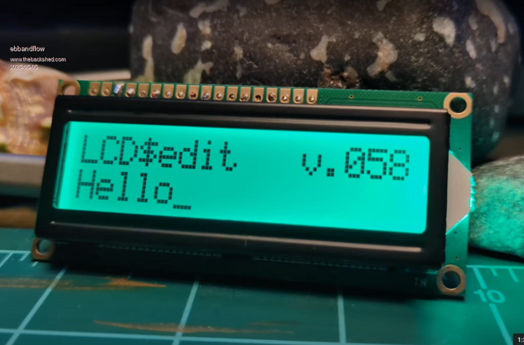

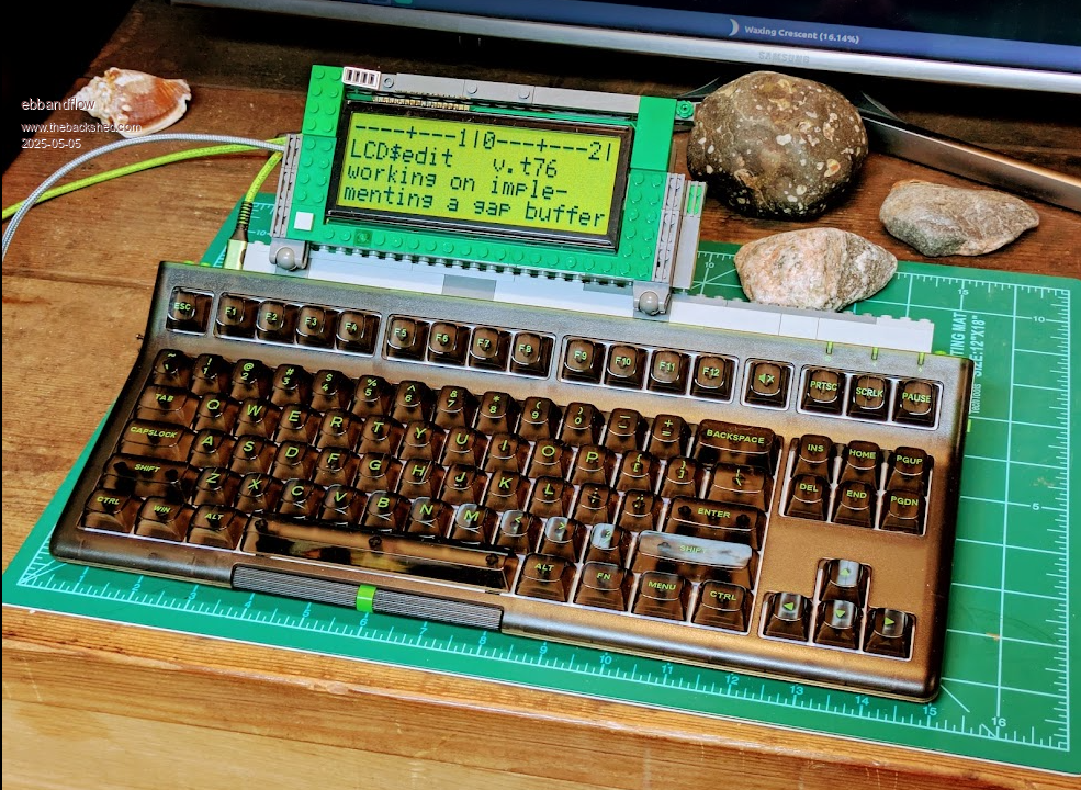

Hello all, I have been working on a little text editor on the picomite for the last few months that targets hd44780 based character LCDs. Until recently I have been using the keyboard via terminal to both write the program and enter text in it while running, but this weekend I switched over to the picomite USB firmware v6.00.01 and connected a USB keyboard directly to the picomite for testing. Straight away I noticed that the speed that I am able to enter characters into the program is much slower than via the terminal, approximately half as fast. Unfortunately the input speed is too much of a bottleneck now, as it dramatically impacts performance, especially after knowing how much faster it can be via the terminal input.
I figure there is a good chance I am doing something wrong here, so I thought I may ask before looking for alternatives. I have no idea but was considering that possibly the extra processing on the picomite's end may be the cause? Do all directly connected keyboards experience this issue or maybe should I try a ps2 variety? I appreciate all input and ideas towards a solution.
James
Edit:
Thought I'd add a few pics
Edited 2025-05-05 11:52 by ebbandflow

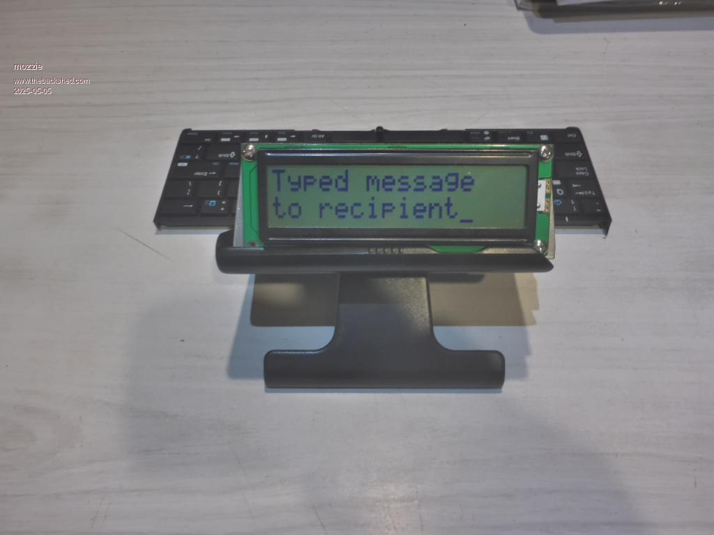

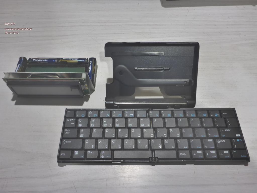

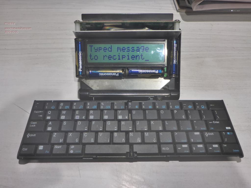

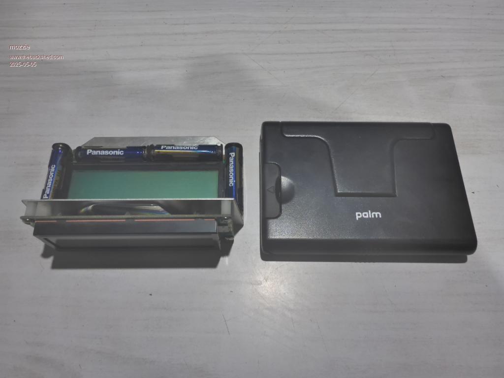

The unit shown below was built for a mate when he had his voice box removed due to cancer, whilst waiting for his talking valve to be fitted and learning to use it.
Turns out he types slower than I do, so not sure how useful it was but it was a great learning curve.
The Palm keyboard outputs IRDA and a PIC16F88 decodes it and outputs the ASCII codes to the LCD's and controls power etc. Took about 3 days to figure out the keycodes etc.
Battery life is great, its been on a shelf for years and although 1 battery had leaked the others still showed signs of life.
Lyle.

Thanks Lyle! I found that keyboard with lego along the top and knew it would be useful. It's not in the final form yet, but great for testing in the interim.
Thanks for sharing about your project for your friend, that's really awesome of you to do for them and quite ingenious of you to use two displays like that! I'm impressed. Did you implement word wrap and scrolling? I'm using those and horizontal scrolling too, with the screen contents being a window into the buffer.
It's been a GREAT learning experience!
