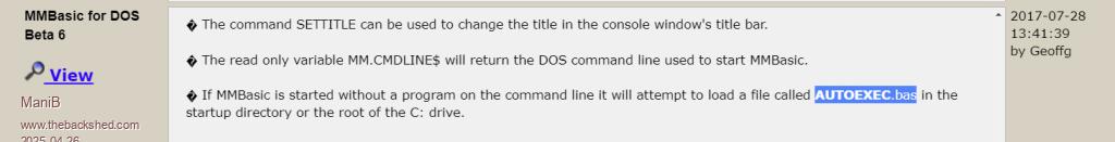

A long time ago wrote Geoff this note about MMBasic for DOS and the AUTOEXEC.bas file:
What's about the PicoMite?
Is there a possibility to execute a certain Basic program on initial power-up, such as AUTOEXEC.bas, if it exists?
