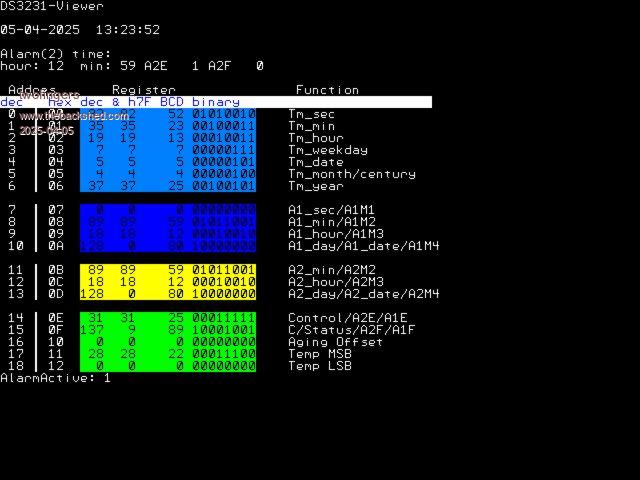

It's not directly related to the question, but I remembered that a few months ago I created (or played around with) some alarm routines for DS3231.
Maybe they'll be useful to someone. I'm not sure if I found the right file, but I think the program illustrates the RTC and the alarm status well. Alarm (2) is set with the "A" key. A routine for Alarm 1 is also available.

@TwoFingers: I like that prog. It would have saved me all the horrible bits n bobs testing to get this far.
